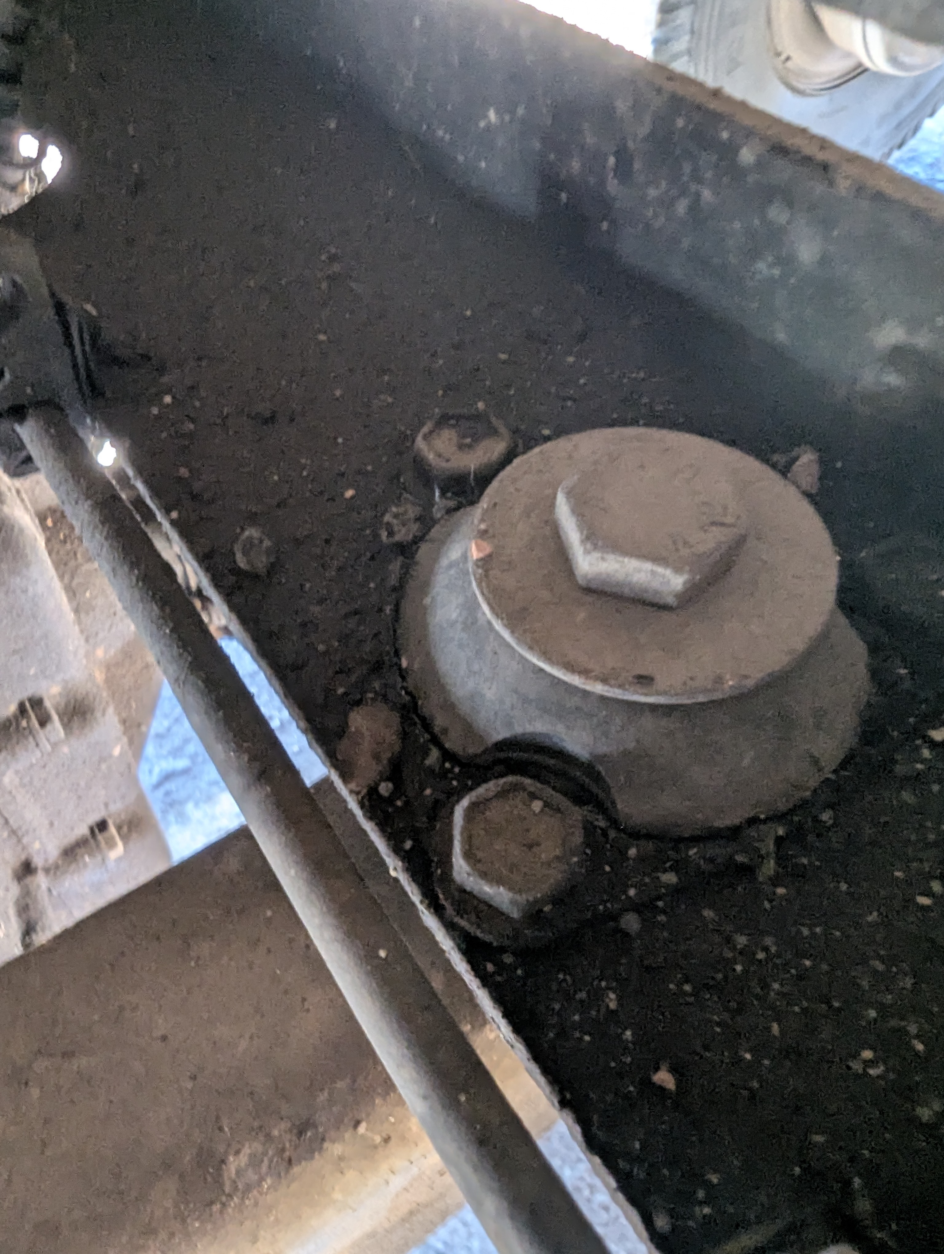

Silent bloc boite transfert - VG100
Message par andrazzz »
Hello!
I have to replace my transfer box mounts (silent blocks).
I roughly measured them while I was under the car. But now I don't have access to the car and would like to buy the correct ones.
I searched and read everything regarding that.
I'm still not sure which one to buy.
I have a VG100 transfer box.
I read that Paulstra 531216 fits Hurth?
Will it fit my Renault too?
Are there any other suppliers?
Cheers

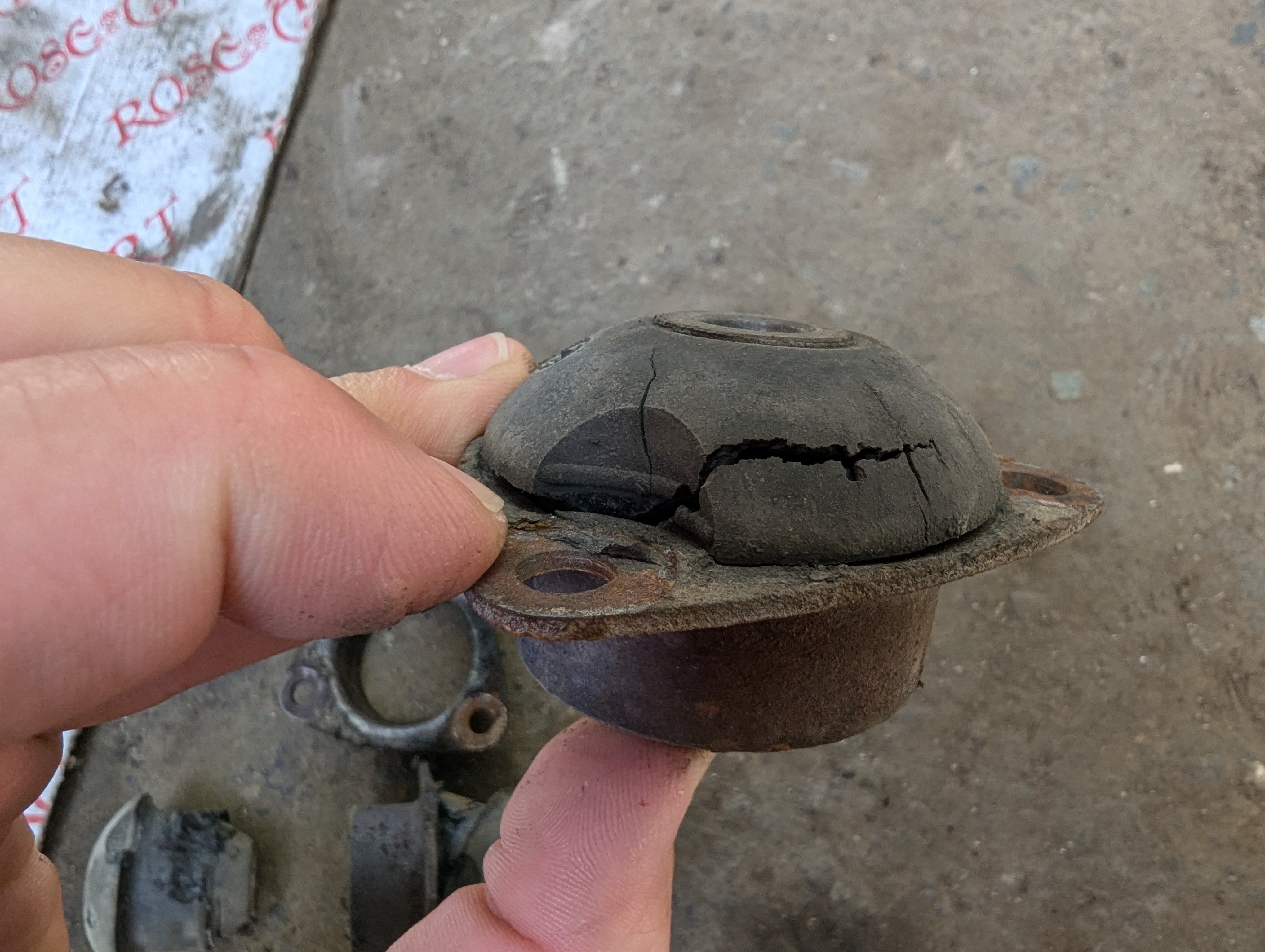

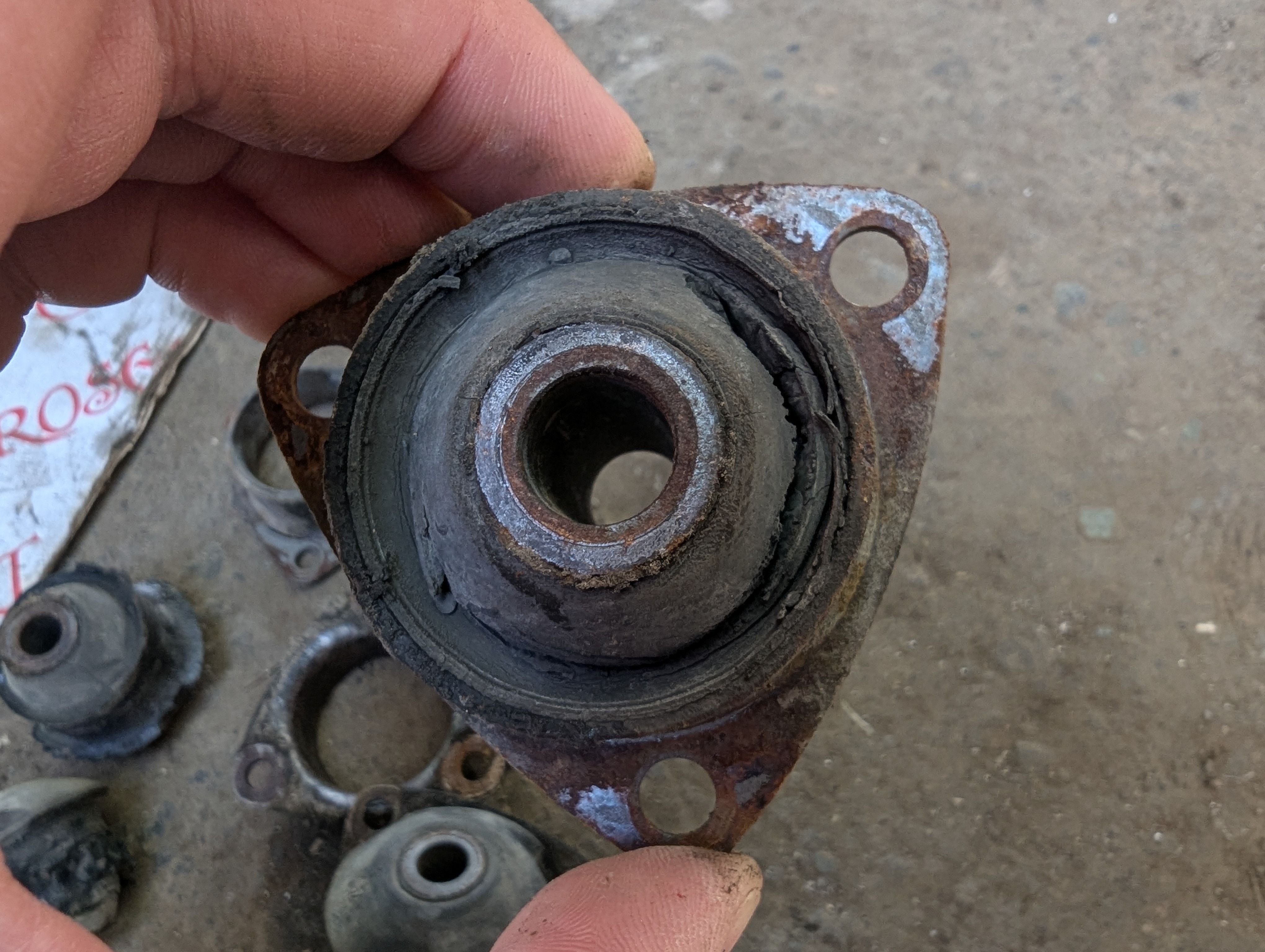

Re: Référence Silent bloc Boite transfert BT
Hello.
Just to let you know. I purchased mounts in the link and they fit perfectly. No vibrations under load anymore 8)
Paulstra 53121675
https://roulementdunet.com/181184-suppo ... sc-10.html
Photos of old ones attached
Cheers, Andraz
