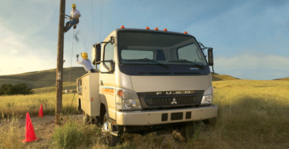

il y a ça aussi :
http://www.mitfuso.com/pages/voc_4wheel.html
A commercial truck that will get you there with traction to spare :
Your job doesn’t end just because the road does. That’s why our medium duty 4X4 FG Model offers 9" of ground clearance, all-terrain tires, heavy-duty axles, shocks and springs, a turbocharged and intercooled higher-torque diesel engine, rugged 2-speed (hi/low range) transfer case and a smooth-shifting 5-speed manual transmission. The FG is one commercial truck that's ideal for applications from light construction and golf courses to utility and energy company service vehicles, even snow plowing. The dependable FG keeps right on going – just like you.
Its all-new cab is fully trimmed and even more spacious, offering added leg, head, knee and elbowroom, new instrumentation, a tilt/telescoping steering wheel, adjustable seating and more. The FG is also available in two different wheelbases and can accommodate bodies up to 16’. The new FG: still the only 4X4 medium duty cabover in the industry.
Mitsubishi Fuso 4x4
Mitsubishi Fuso 4x4
medium duty 4x4.jpg (35.48 Kio) Vu 19870 fois
