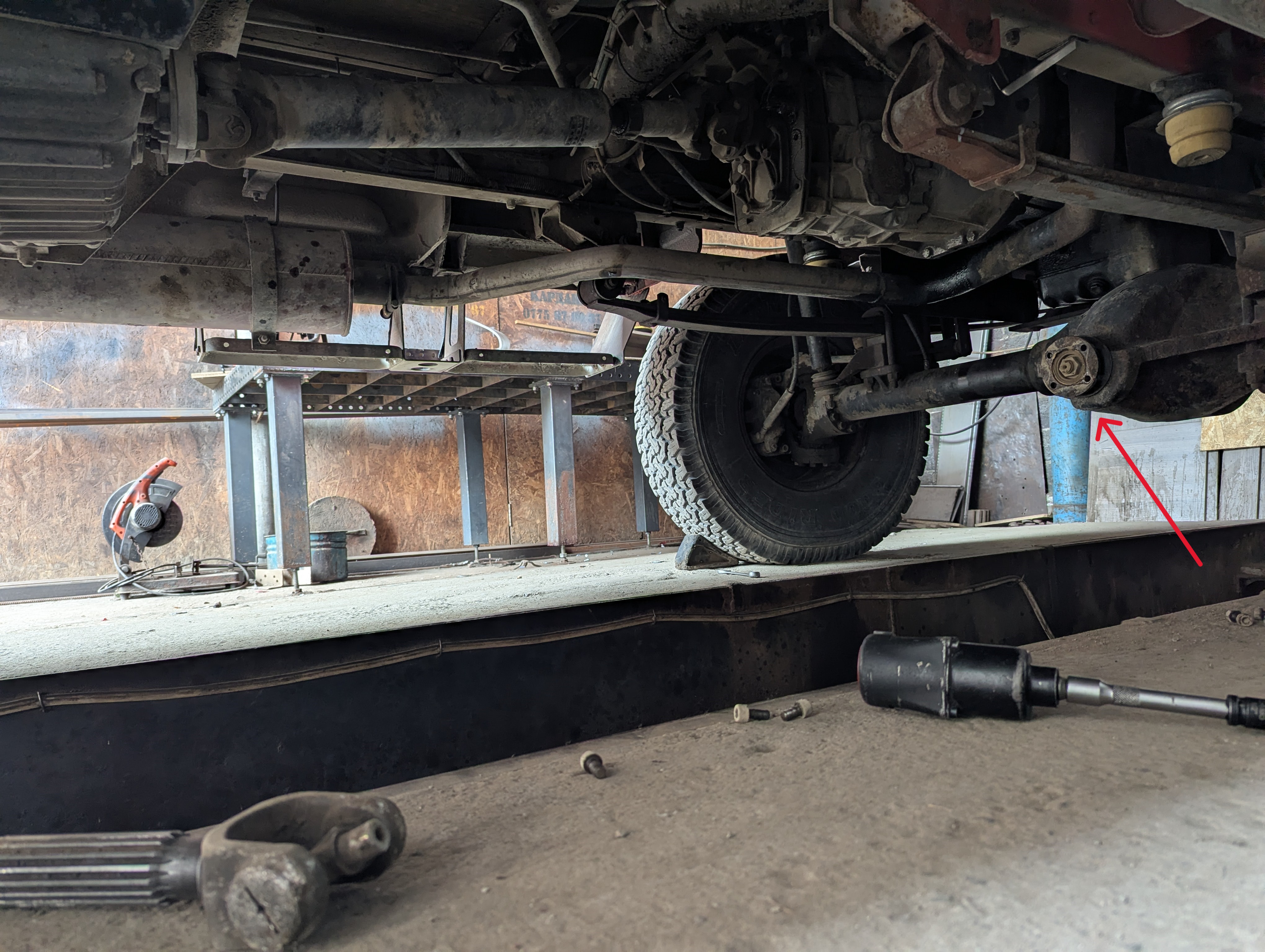

My front differential (PA 569) has a worn pinion bearing. Most probably because the front drive shaft was out of balance for too many kilometers.
When I rotate the flange by hand, it doesn't run smoothly. I guess the outer pinion bearing should be replaced soon.
Does anyone have any information or experience with the replacement?
Cheers

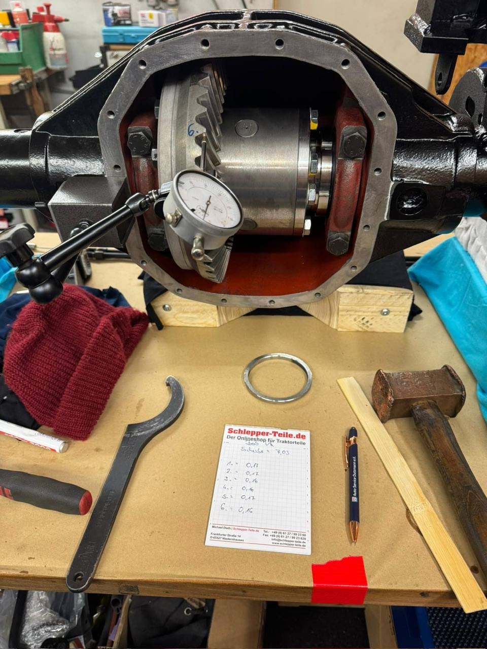

Are you familiar with metrology tools and process like with comparator ?
Usually when you already have play and misalignement in one of the pinion gear bearing the second is probably wasted too.
The problem with that is that if you need to change the two bearings you have to make sure to adjust the bearings preload, the pinion-crown distance and the teeth backlash, only with rectified shim. It can be a loooong work, take multiple assembly try before find the right setup. And if you just mess it or get bored to tune it properly your hypoid gear will just insanely be weared in no time.
If any doubt, it could be wise to ask to a professional machinist to perform the operation.
