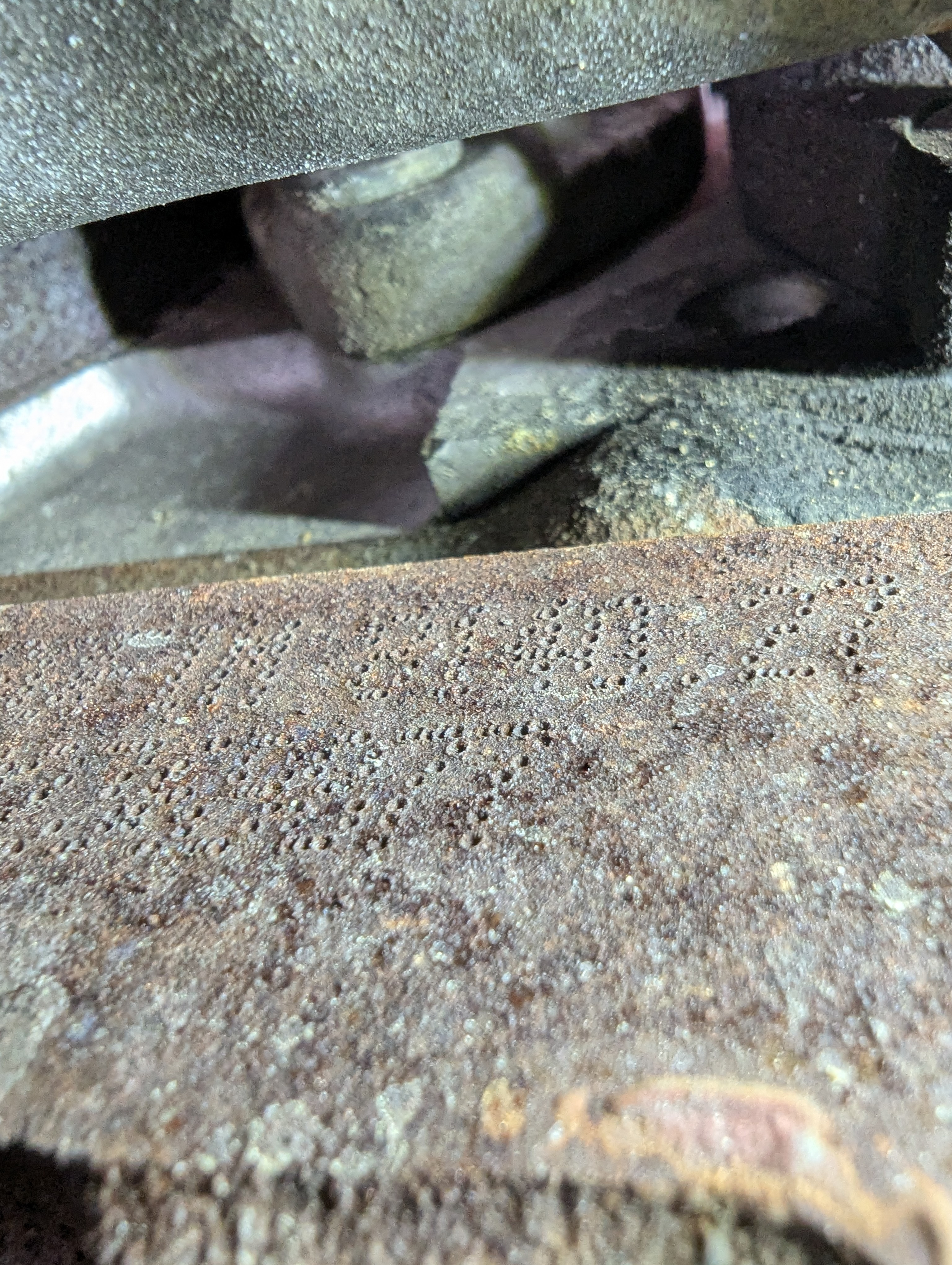

andrazzz
- Guide
- Messages : 27
- Enregistré le : 29 nov. 2024 09:49
- Nom du véhicule : Renault
- Type de véhicule : Messenger
Re: Code moteur
I just couldn't wait
So I tried with a torch and my phone. After many attempts I somehow got it
Not easy but doable.
It's 8140.27
Thanks everyone for your help and ideas.
Cheers
It's 8140.27
