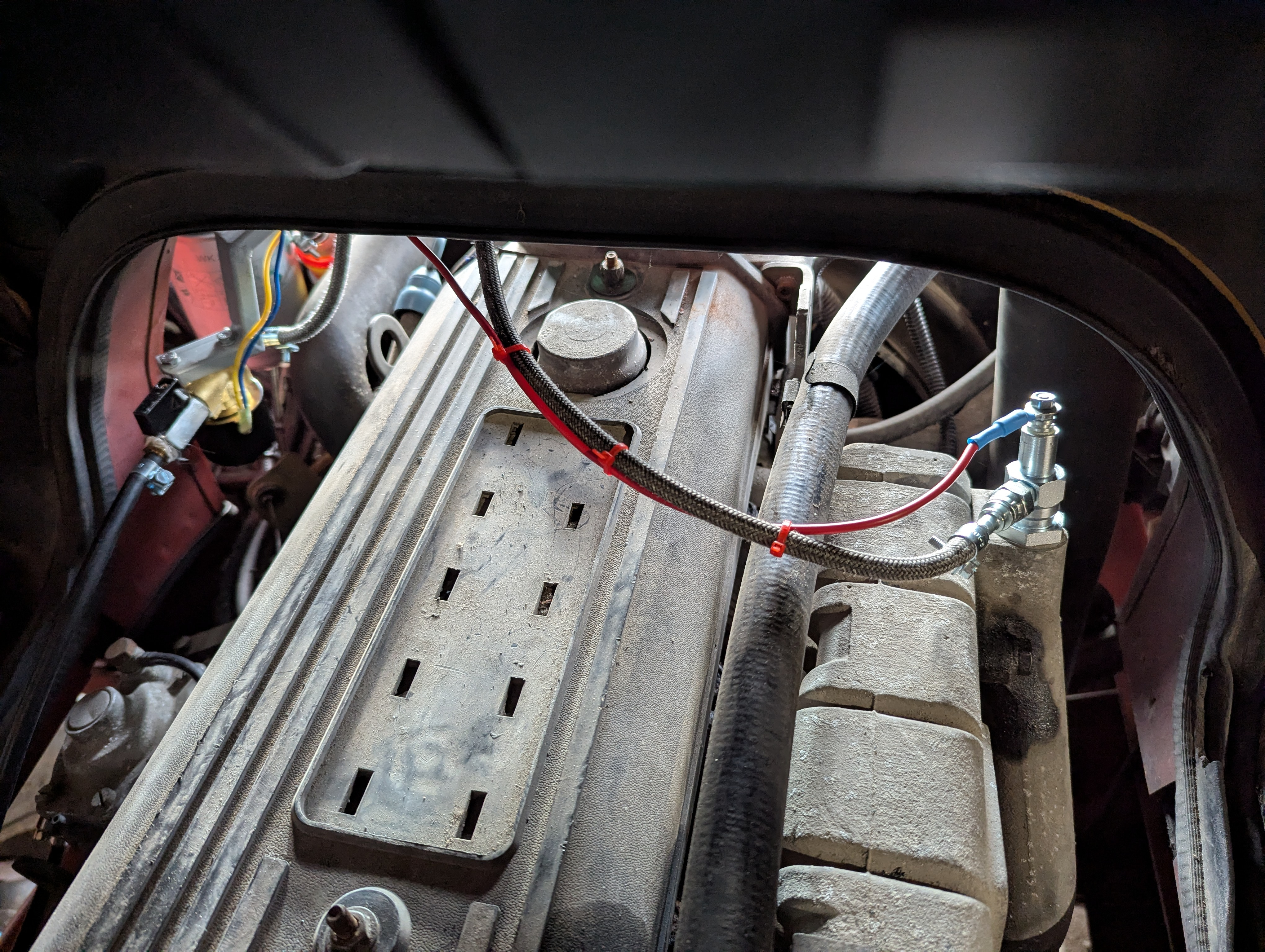

Hello!
I just want to be sure what engine code is the engine I have.
Can anyone tell from the photo?
It's turbocharged, chain driven and without intercooler.
Cheers

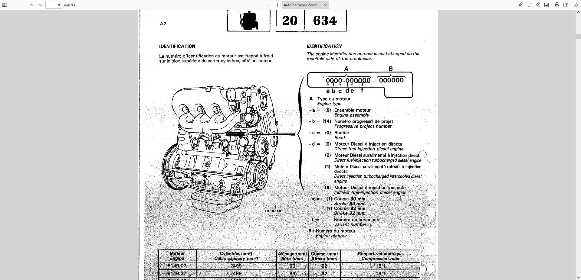

Hallo andrazzz,
Il s'agit probablement d'un 8140.27 2,5 litres

Hello Andrazzz,
8140.27 is also in your own manual.
But it's not quite that simple:
https://en.wikipedia.org/wiki/Sofim_8140_engine
I don't know to what extent the version with timing chain has different engine codes.
8140.pdf
(51.09 Kio) Téléchargé 92 fois

Hi,
The best way is to check the number engraved on the engine.
For exact location, look at the diagram published by "B120 Frankfurt". This number is not easy to access... If it's as difficult as the Iveco Daily (same engine), you may need to remove the alternator and possibly the exhaust manifold to see it. :102:

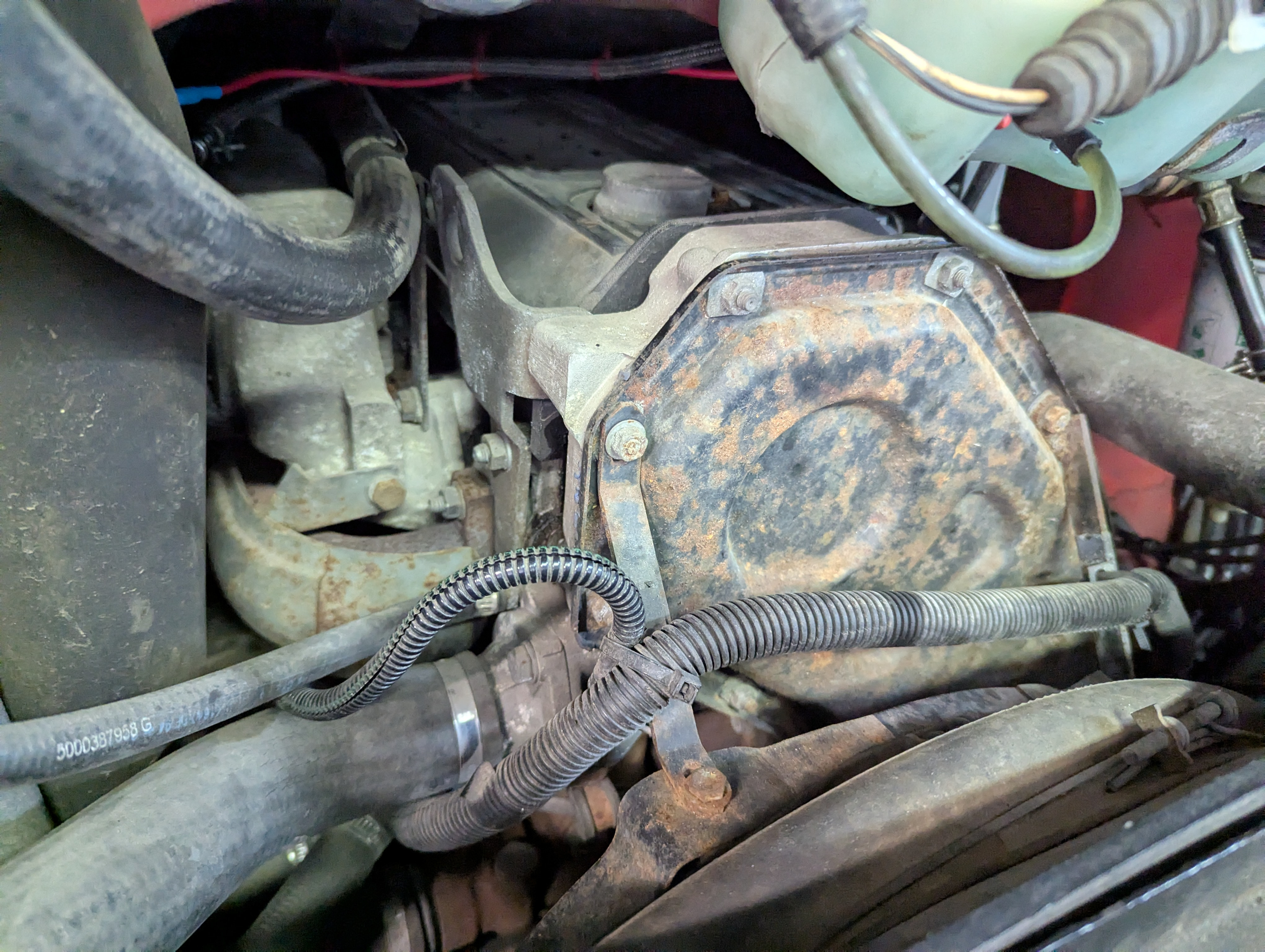

I just couldn't wait :)
So I tried with a torch and my phone. After many attempts I somehow got it 8)
Not easy but doable.
It's 8140.27
Thanks everyone for your help and ideas.
