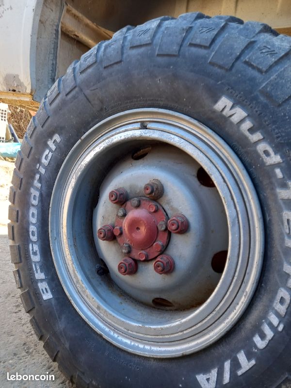

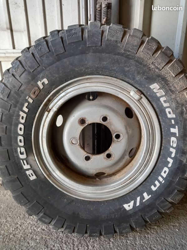

attention ces 6.5 ont un déport identique a celles des bremach ou "nouveaux ivecos" qui ne passe pas avec la porte latérale si vous montez du 255x100r16 . (mais en goodrich oui)

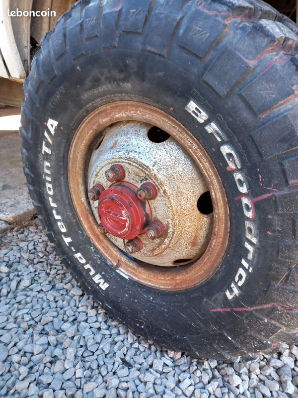

jantes de daily 4x4 en 6.5 et 5.5

Are they tubeless?
- Messages : 21483
Re: jantes de daily 4x4 en 6.5 et 5.5
I doubt it but it's difficult to know just from those views, the 5.5 do not exist tubless with circle, the 6.5 do exist in both versions.

actually on that one you can see from the valve that it is tube type as well not tubless

basically they are the same as yours download/file.php?id=84130&mode=view
but they stick out more (wider on the vehicule) wich looks nice but can be a trouble with your sliding door if you put tires bigger than 255x85r16 :
so no 900r16 or 255x100r16 for example
