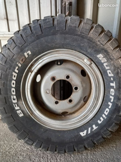

attention ces 6.5 ont un déport identique a celles des bremach ou "nouveaux ivecos" qui ne passe pas avec la porte latérale si vous montez du 255x100r16 . (mais en goodrich oui)
jantes de daily 4x4 en 6.5 et 5.5

Are they tubeless?
- Messages : 22837
Re: jantes de daily 4x4 en 6.5 et 5.5
I doubt it but it's difficult to know just from those views, the 5.5 do not exist tubless with circle, the 6.5 do exist in both versions.

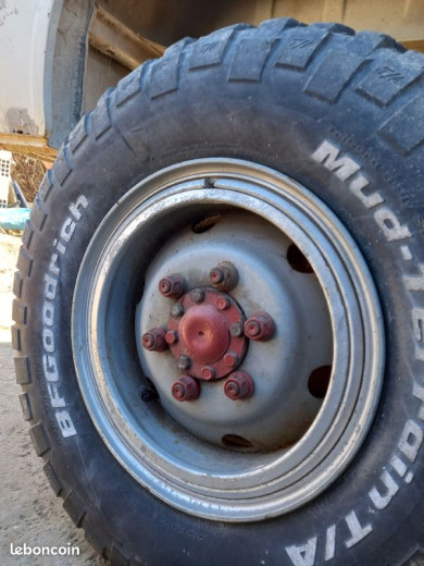

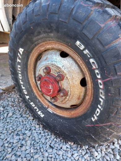

- Messages : 22837
actually on that one you can see from the valve that it is tube type as well not tubless
- Messages : 22837
basically they are the same as yours download/file.php?id=84130&mode=view
but they stick out more (wider on the vehicule) wich looks nice but can be a trouble with your sliding door if you put tires bigger than 255x85r16 :
so no 900r16 or 255x100r16 for example
