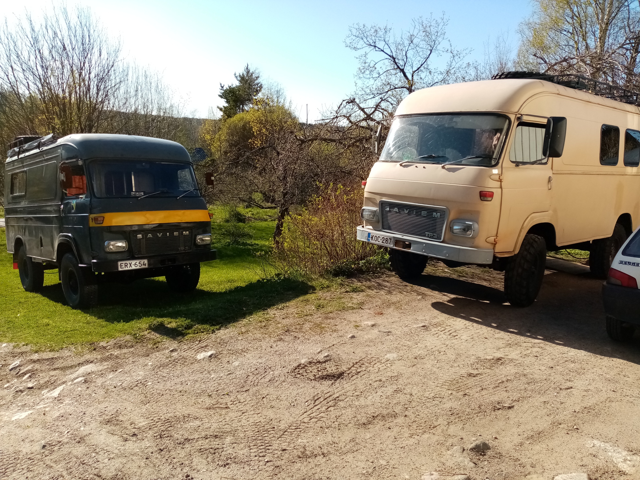

We were touring Lake Ladoga with Volvo c303 and c306 cars. On the evening campfire, I told you that I would like to buy some different 4x4 car. A week later, a friend of mine sent a picture of tp3. I bought it, the year was 2007. 2 years of construction. I bought another tp3 in 2017. the first one I installed a Man diesel and the second is a Nissan sd33 engine. In this picture, both beauties

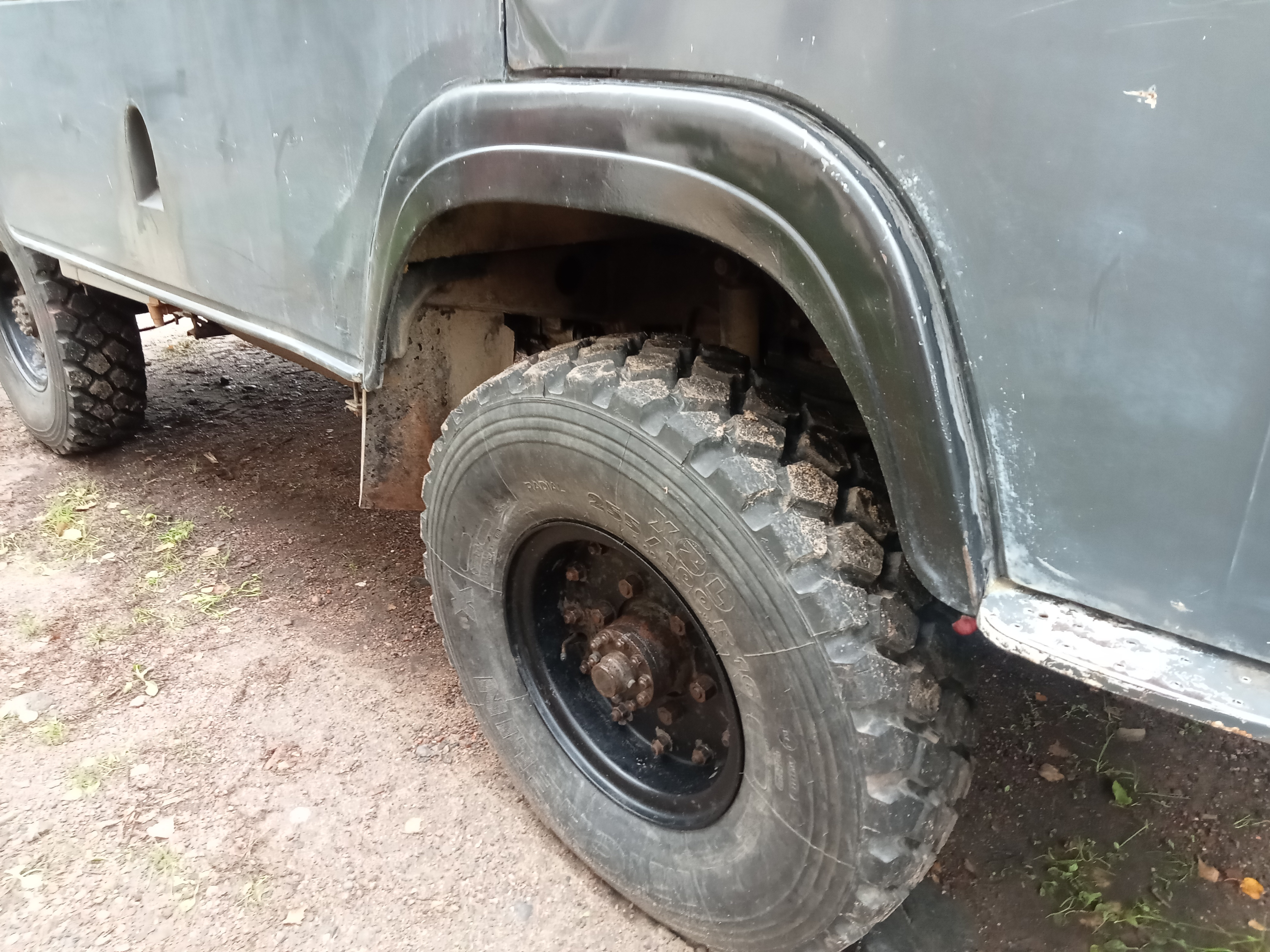

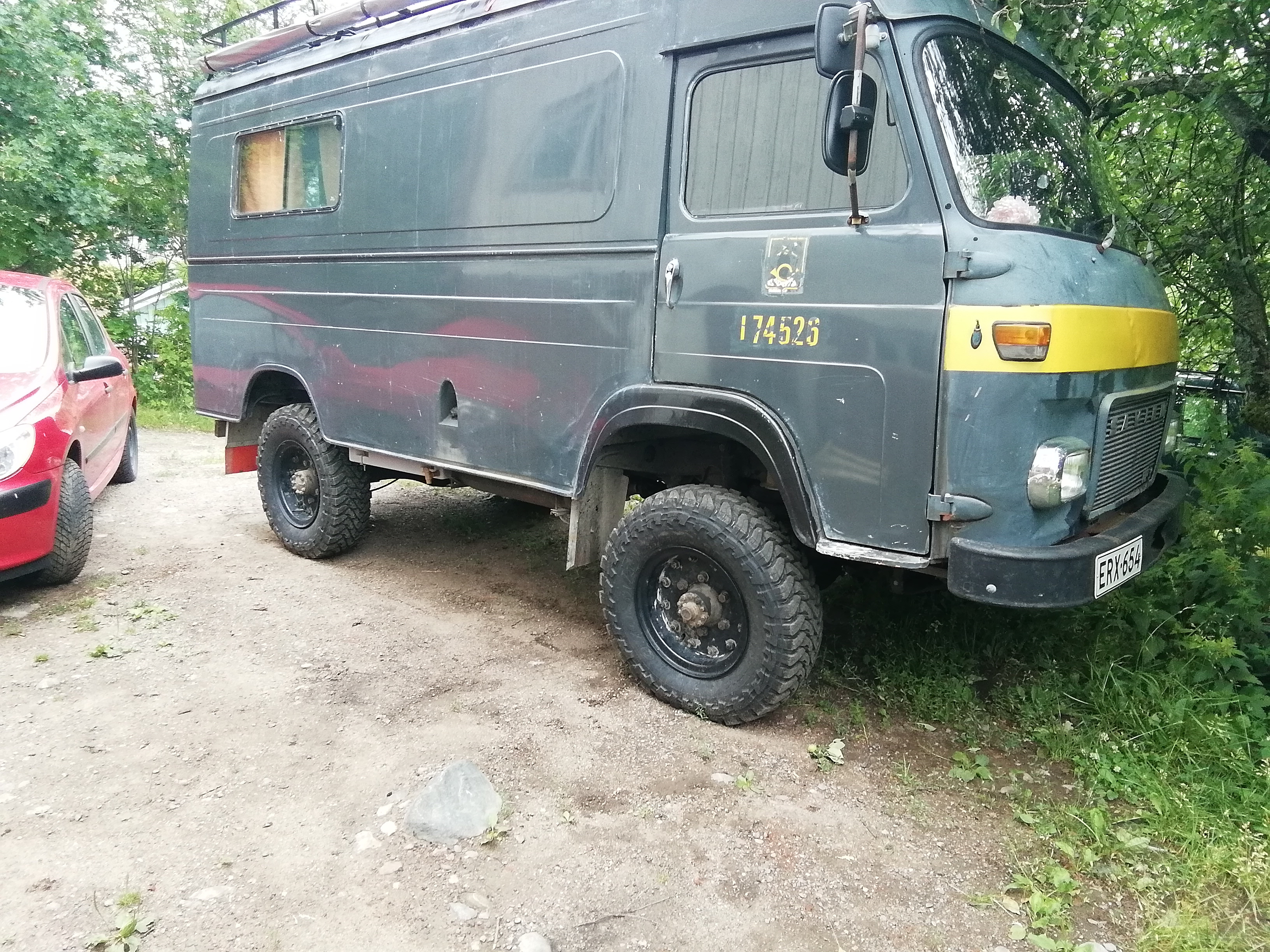

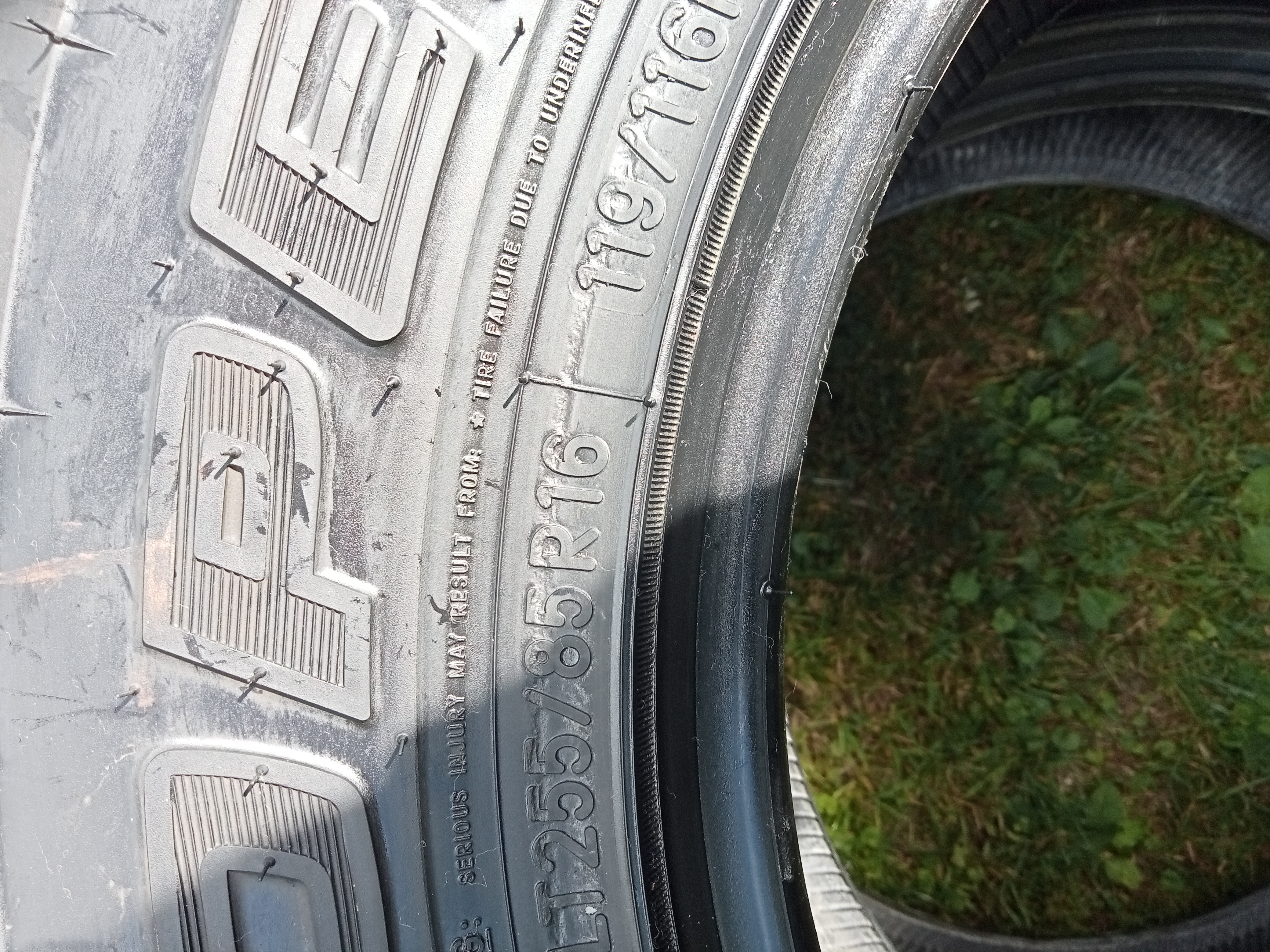

New tires installed. (255 /85r16)

after a few hundred kilometers I changed the old ones tires back. The new ones didn't fit on those rims. Terrible vibration
- Messages : 21542
Re: Greetings from Finland
interresting, what makes you think the tires didn't fit the rims and would be the cause of vibrations ?
I mean I do understand that if your old tires are fine it is the tires that are the cause but can't it be that on another car or other rims it would have been the same ? did you try to get them properly balanced (I mean with led)
and what brand are they ? because some tires are just not well balanced and sometime impossible to get balanced. or the disposition of the rubber pad make resonnance even though they look very much like well known brand like goodrich (blackstar just to give one name as an example). viewtopic.php?p=115620#p115620

They tried to balance the tires, but the throw was 500-600g. The vertical throw could be seen with the eyes by approx. 10mm. The tires were turned to a different position, but it didn't help. The reason is probably that the edge of the rim is significantly higher than tubeless rims. You can see the mark left by the rim on the edge of the tire.

thank you for those precisions, we could be sure it is the reason only if they fit alright on other rims though...
but I am tracking that type of issue on another topic viewtopic.php?p=211106#p211106
is the brand of yours " cooper" from what I see here ?

The tire has a high rim protector which apparently caused the problem. The brand is Toyo open contry m/t

some bad and good about those tires here search.php?keywords=toyo+open
otherwise note that on some goodrich at the time we had to cut away the sticking out rubber shape supposed to protect the edge of the rim due to that heigt difference. but note as well it would be strange if they do not turn round due to that because it is the inner circle that is supposed to locate them on the rim not the outer.

I finally got the tires. Old but unused

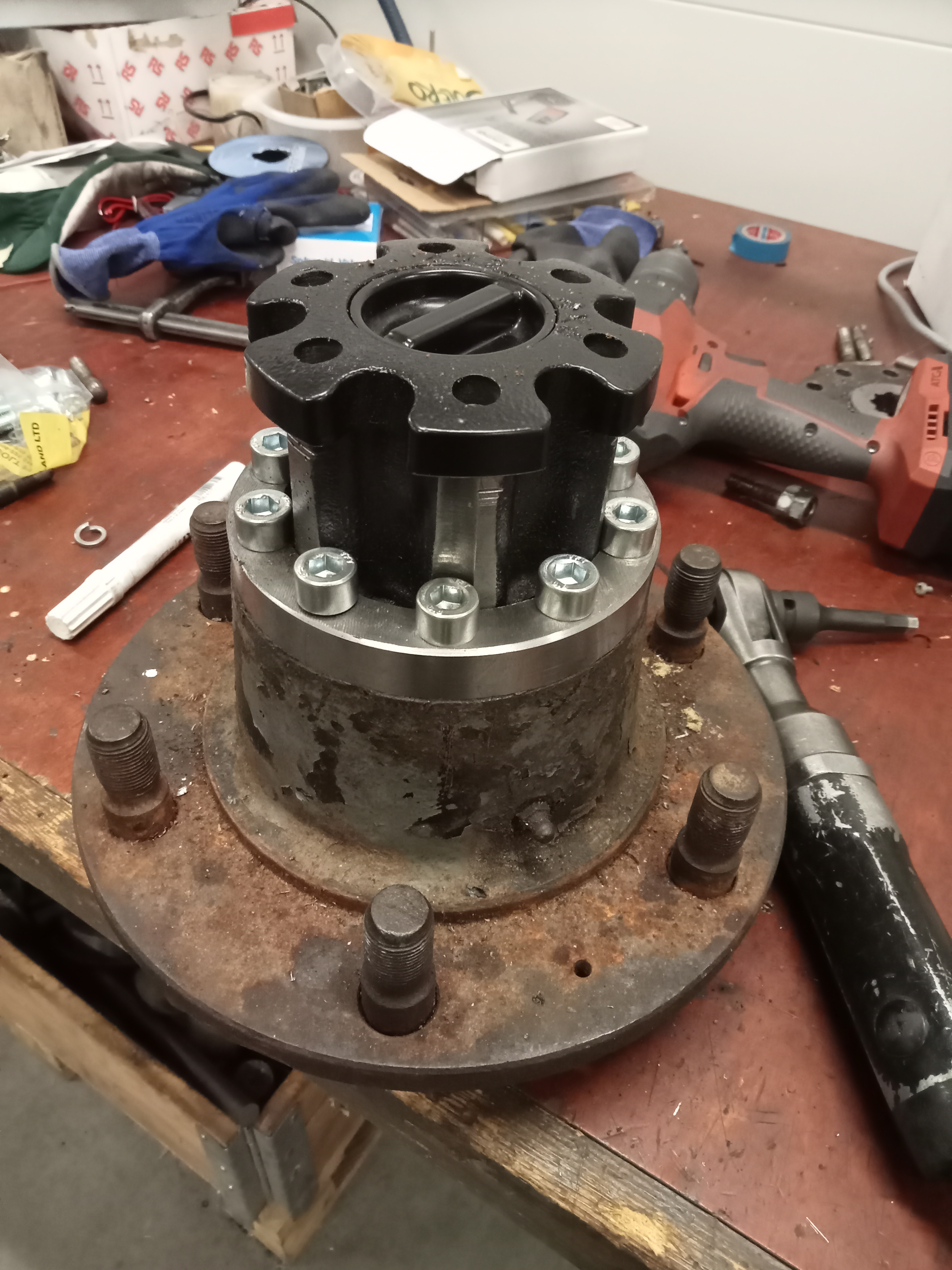

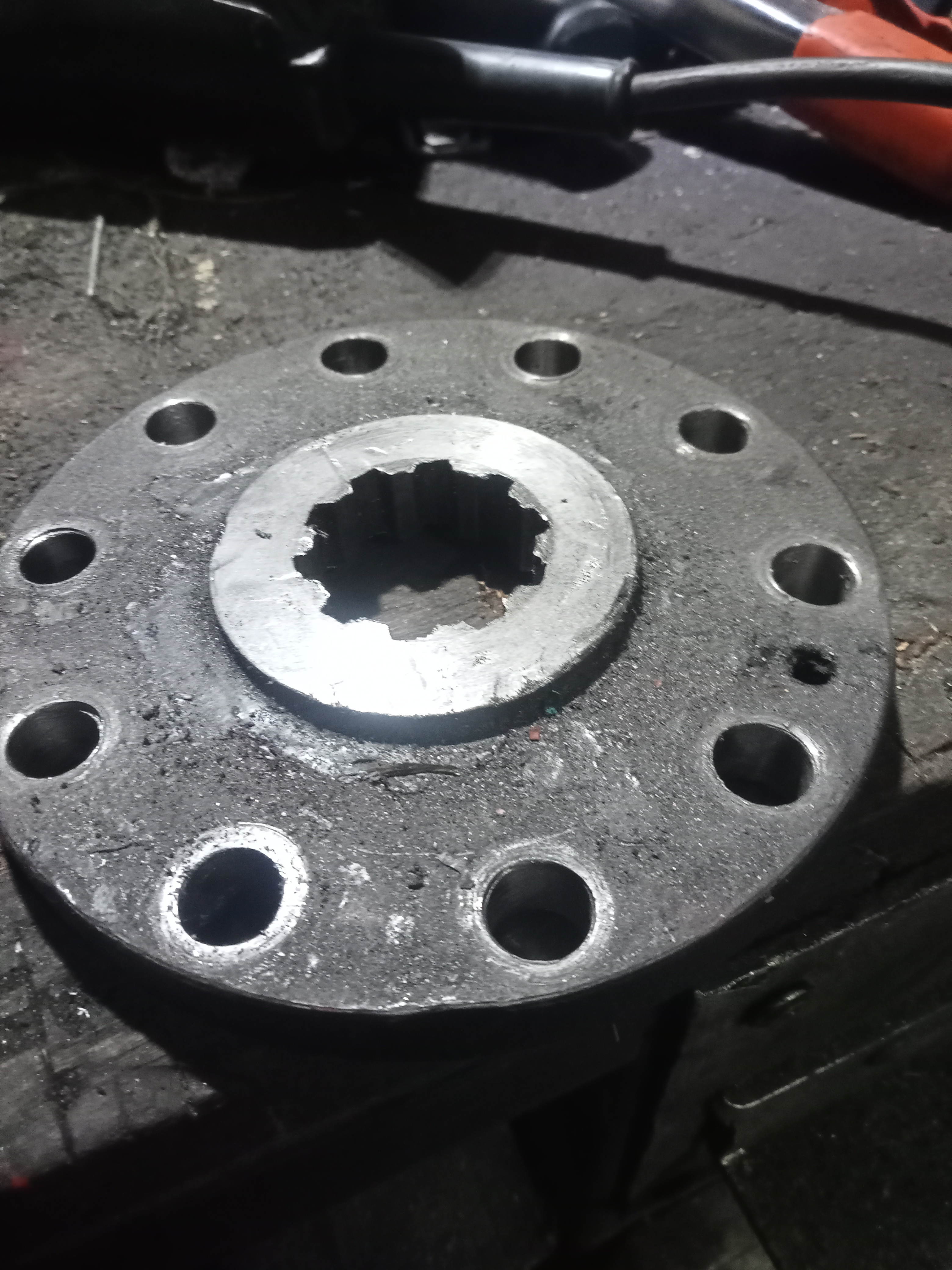

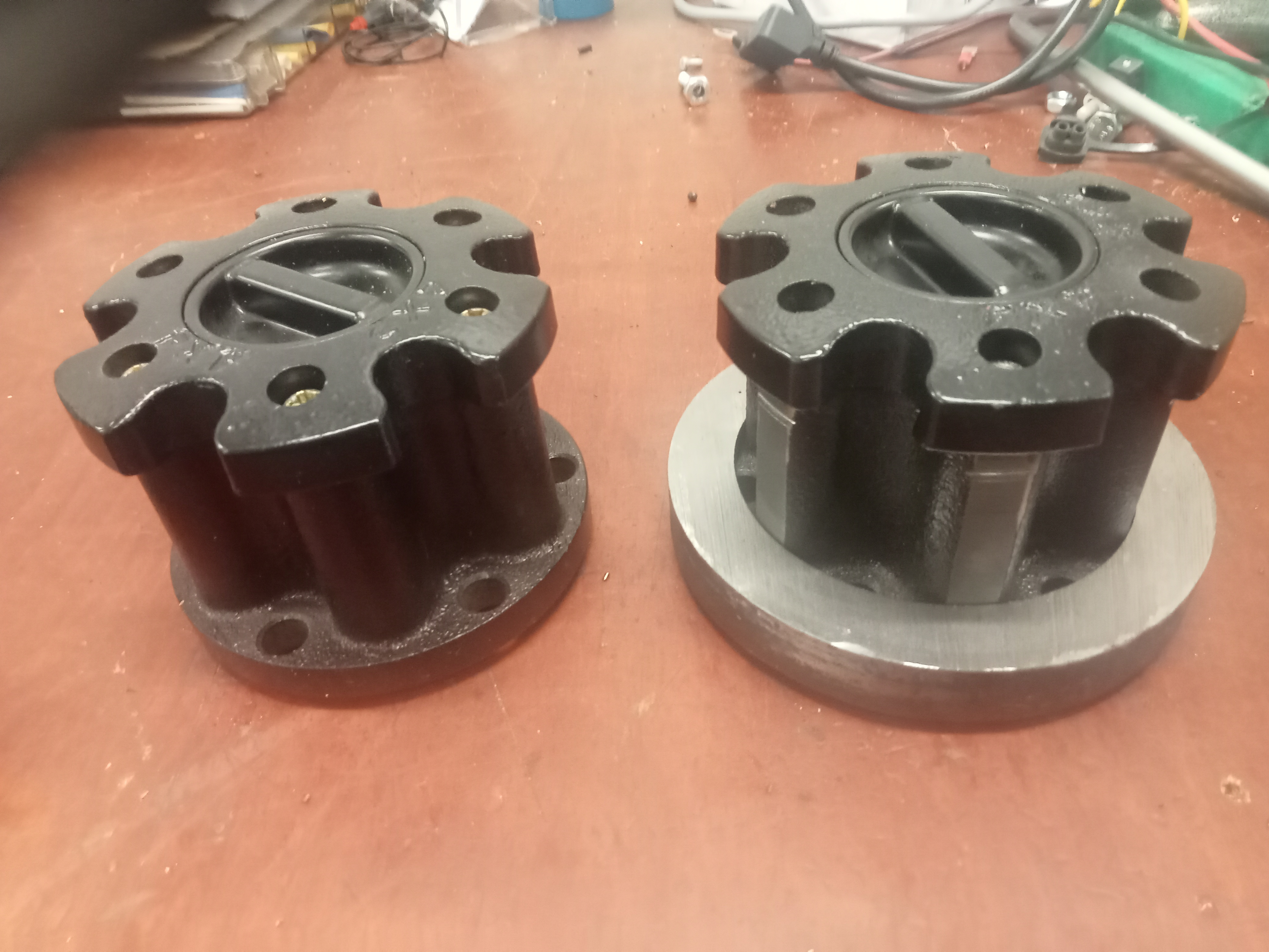

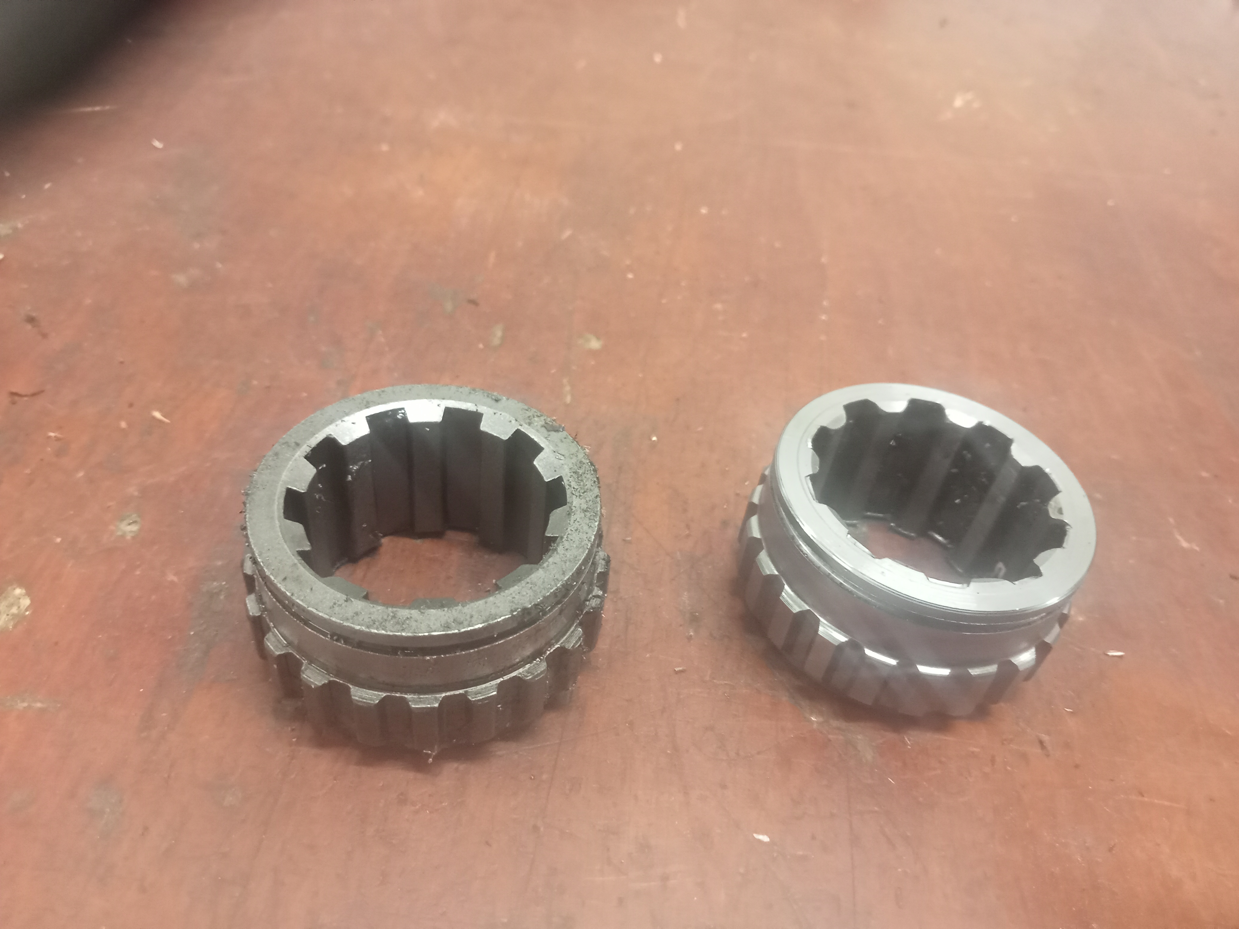

I also started a hub lock project. A new innermost part and mounting flange.
The lock is a modified UAZ
I have a spare part shaft, the inner part of which was made to attach the drive shaft from the flange. I haven't installed it in the car yet

Hello, very interesting projecttp3 finland a écrit : 01 oct. 2024 06:36 I also started a hub lock project. A new innermost part and mounting flange.
Did you machined custom inner splinned ring dédicated to the TP3 that goes into the UAZ hubs ?

A pièce was cut from the original hub and grooves were machined on the outside.
Here I found measurements based on which I ordered hub locks from China
https://www.avm.com.br/products4.htm
