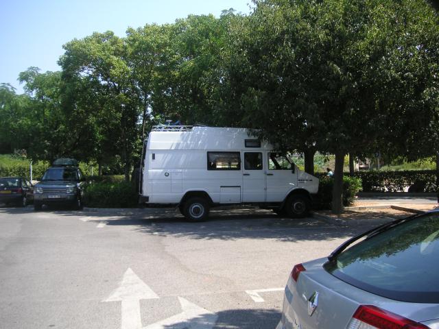

Its only few days ago that I found out that the b has exactly 3.200 distance between front and rear axle just like your iveco.
and I did buy a long iveco just as rusted as yours with the intention to make a longer one too.
but i will use a polyester body instead because I want it to be wider as well, in order to be able to sleep in the width.
and that is difficult to do so in the current size.
in the following examples you'll see that some did like what you intend to do but we have very little feed back about those , one of them is currently in south america for a long trip: wopwop and as far as we know he didn't have any trouble.
http://forum.bernard.debucquoi.com/memb ... file&u=990
and manymore with a polyester body link to the original driving cab.
http://forum.bernard.debucquoi.com/down ... =23029&t=1
http://forum.bernard.debucquoi.com/down ... d=1044&t=1
