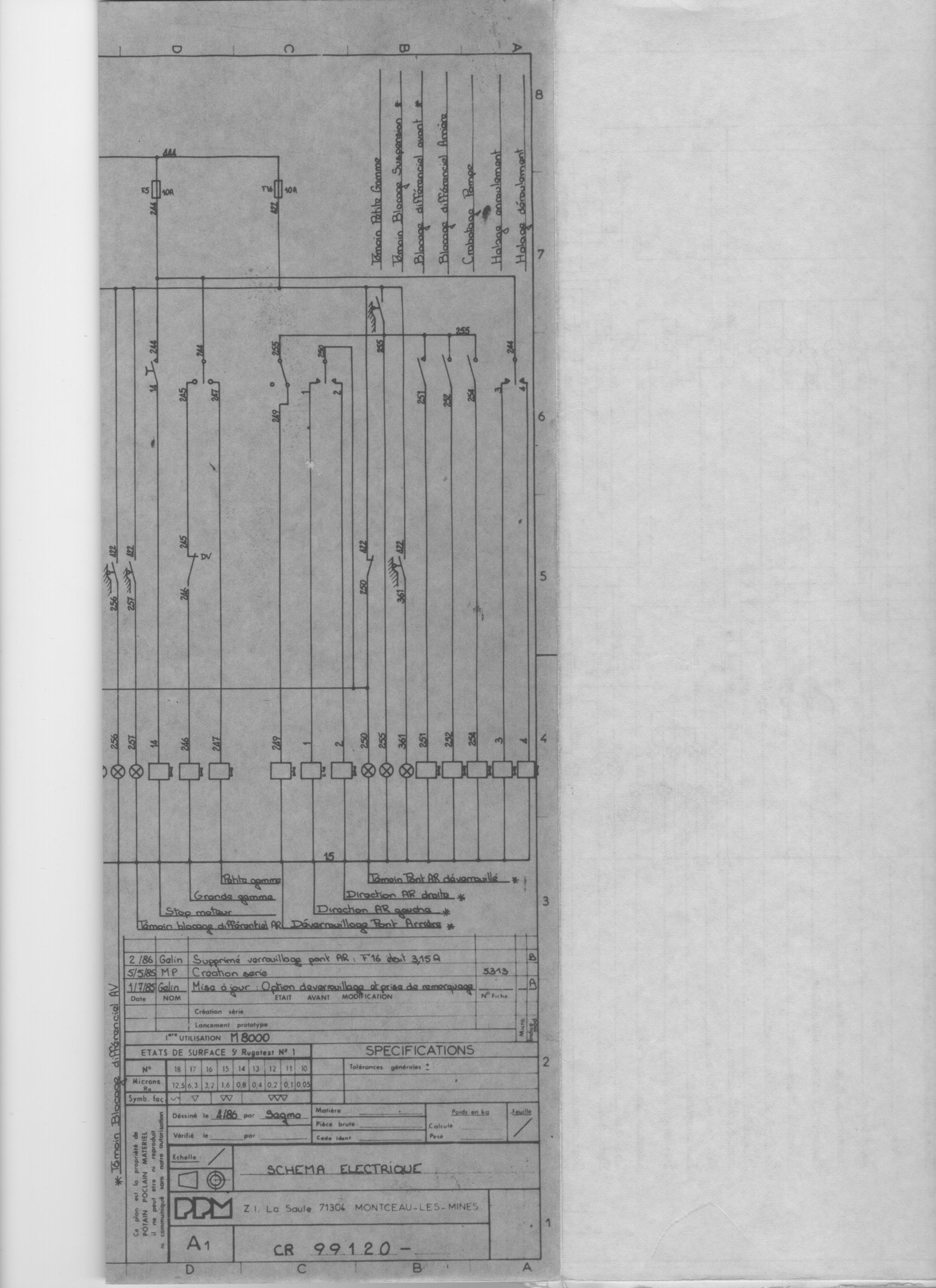

hello our friend,
Attached is the electrical diagram of the M8000. the Brimont apache is identical apart from the specific addition to the fire system.

Re: BRIMONT APACHE
Thank you very much.
I hope i can read or decipher everything.
It will be very helpful to repair the dashboard.
