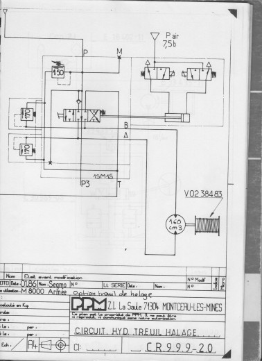

My new problem is the winch. It doesn´t work. Does someone know how to adjust the levers at the rear of the truck above the AR?
You can feel the pressure in the tubes but the reverse running of the winch seems to be closed. The levers can be pushed but the main contrôle of them works with compressed air.

I know that there are some differences between the Apache an the PPM, but the châssis with 4x4x4 is the same. The wiring is terrifying, mostly small white, non labeled wires an no circuit diagram.
The electrical winch contrôle is in the cab, thats right. But the valves (pneumatic activated) for winch or pump contrôle are at the rear.

I received some tips today for fixing the winch, i hope its working.

The hydraulic circuit of the winch with the pneumatic contrôle is attached. Then, a complement to the electrical diagram. operation of the winch "halage" with relays 3 and 4.
