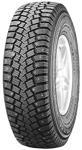

NOKIAN HKPL LT 235/85R16 120/116Q        149 EUR
