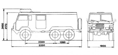

VEHICLE SPECS: VOLVO C304 / TGB 13
Source: "Volvo Operator's Manual: Terrängbil 11 and 13"
Volvo C304 / TGB 13
General Info
Military type name TGBIL 131A
Volvo type name C304, C03 6x6-1-V, 4143
Overall length (including tow hook/eye) 5,35 m
Overall width 1,90 m
Height 2,17 m
Height (including weapon mount) 2,27 m
Ground clearance 0,38 m
Turning circle 14,40 m
Wheel base 2,30 +1,05 m
Track, front 1,54 m
Track, rear 1,54 m
Tires 280/85R16 4 ply
Tire pressure 1,7 kg/cm
Maximum number of passengers driver + 6
Vehicle Weight
Curb weight 2820 kg
Total weight 4400 kg
Maximum weight on front axle 1700 kg
Maximum weight on rear axle 3000 kg
Maximum load 1500 kg
