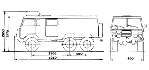

VEHICLE SPECS: VOLVO C304 / TGB 13
Source: "Volvo Operator's Manual: Terrängbil 11 and 13"
Volvo C304 / TGB 13
General Info
Military type name TGBIL 131A
Volvo type name C304, C03 6x6-1-V, 4143
Overall length (including tow hook/eye) 5,35 m
Overall width 1,90 m
Height 2,17 m
Height (including weapon mount) 2,27 m
Ground clearance 0,38 m
Turning circle 14,40 m
Wheel base 2,30 +1,05 m
Track, front 1,54 m
Track, rear 1,54 m
Tires 280/85R16 4 ply
Tire pressure 1,7 kg/cm
Maximum number of passengers driver + 6
Vehicle Weight
Curb weight 2820 kg
Total weight 4400 kg
Maximum weight on front axle 1700 kg
Maximum weight on rear axle 3000 kg
Maximum load 1500 kg
Engine
Type name B30A
Power at 4000 rpm 117 hk / 86 kW
Torque at 2500 rpm 206 Nm / 21 kpm
Numbers of cylinders 6
Bore 88,90 mm
Stroke 80 mm
Capacity 2,98 L
Carburetor x 2 Zenith-Strombergh 175 CD 2 SE
Electric system 24 volt
Main gearbox
Type name ZF S4-18
gear ratio 1st gear 3,85:1
gear ratio 2nd gear 2,08:1
gear ratio 3rd gear 1,39:1
gear ratio 4th gear 1:1
gear ratio reverse 4,13:1
Transfer case
Type name Volvo FD 51
Gear ratio low range 2,39:1
Gear ratio high range 1:1
Axles
Gear ratio axle 3,44:1
Gear ratio wheel gear 2,06:1
Differential lock both front and rear
Dual circuit hydraulic brake system with drums
2 slave cylinders/wheel
Maximum speed
1st gear low 10 km/h
2nd gear low 19 km/h
3rd gear low 28 km/h
4th gear low 39 km/h
1st gear high 24 km/h
2nd gear high 44 km/h
3rd gear high 66 km/h
4th gear high 92 km/h
Capacities
Fuel tank 84 liter
Cooling system 12 liter
Engine 5,2 liter
Main gearbox 1,2 liter
Transfer case 1,3 liter
Axle gear 1,5 liter
Front wheel gears 0,3 liter
Rear wheel gears 0,4 liter
Steering gear 0,5 liter
