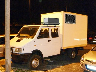

Hi there!
I haven't got much time to post pictures. These months were time to get the money and buy everything for the Iveco M.A.D Project.
At this time i have the box done, with windows and rooflights, i am doing the interior my self, i have part of it, but i still have to do 60% of the furniture. This will not take much time, everything is already drawn, and i hope that with more 12-18 hours of Cnc/Cam cutting i will have everything.
I am still trying to find an extra wheel, and as i did with the Truma Combi Diesel, so for the Webasto Diesel Cooker i am waiting to see if something used comes up in the houses that dismantle the crushed motorhomes in the UK, as i did with the doors and the Truma Combi Diesel system.
I hope next week i can get time to post some pictures as it is, but i am confident that before Christmas the truck is ready!
When i was doing the research for witch would be the best interior layout i saw that one from the guys of UNICAT, it is a very good one, i just don't have so much space, and i have to be careful about the weight, that is why i am doing the furniture myself in abs plastic, because like this i can do holes and subtract a big part of the material not affecting the structural forces needed.
Hope to post more soon!

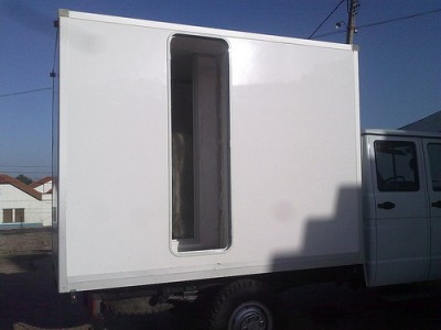

Il ya longtemps que je n'ai pas donné de nouvelles, ou de publier des photos.
Une grande partie de ce temps a été consacré à gagner l'€ € € nécessaire pour acheter le chauffe-ands la cuisinière, et maintenant je peux dire que tout est déjà acheté.
J'ai été sur eBay pendant une longue période d'attente de trouver un Webasto Diesel Cooker X100, et un chauffe-eau et l'air Truma Combi diesel, et finalement je les ai!

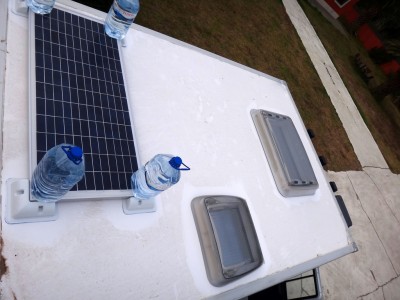

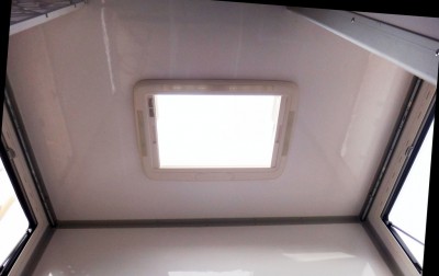

J'ai déjà la boîte dans le van, et j'ai également installé les fenêtres, porte bagages et les lumieres de toit dans la cellule.
J'ai aussi monté une galerie de toit Yakima (modifié et plus pour couvrir toute la cabine).
Je suis en train de (finish?) l'intérieur instalations techniques (eau, déchets, et électrique) et la partie structurelle du mobilier.
J'espère que dans 15 jours, je peux poster des photos récentes et actalized.

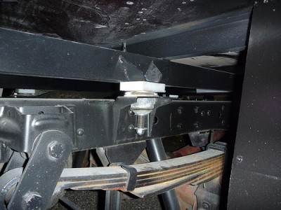

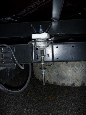

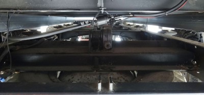

Ce sont de vieilles photos, mais de toute façon vous pouvez voir le système de support choisi

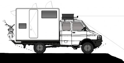

Un vieux dessin fait ...
La porte (ebay aussi) est parfait!

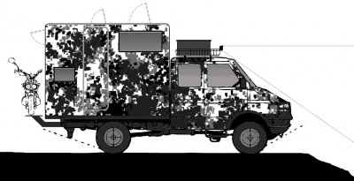

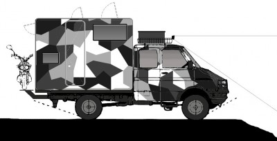

Je me rapproche d'finnois le projet, est j'ai le temps pour réfléchir sur les détails.
Je vais construire un plateau arrière pour ma moto et / ou des vélos.

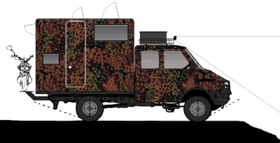

Je vais aussi utiliser ce dessin pour faire des études pour la décoration vynil sur le côté de sortie.
Je vais essayer d'utiliser certaines cammo (camouflage) urbaine modifie sur le camion et sur la cellule, pour unifier les deux.
Je vais les faire et être de les afficher pour obtenir votre avis

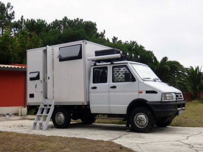

Update de fotos de exterior...

Ce qui attire mon oeil, c'est ta roue de secours...
Peux-tu me dire comment elle est fixée et à quel endroit exactement ?
Merci d'avance.

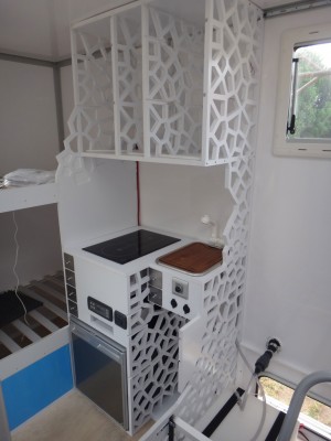

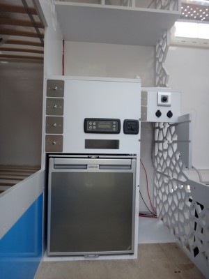

Il est du CELUCA PVC (plastique) Foam. Utilisé dans les tables de cuisine et plans de travail.
J'ai coupé tous les meubles dans une machine CNC. Ils on faite à partir de la géométrie de Voronoï, puis j'ai aplied un script informatique, quis est capable de calculer la contrainte de poids, et en considérant le poids tout l'intérieur des boîtes IKEA aurait, combien pourrais-je prendre de l'le tournant aussi légère que possible.
En fin de compte je pouvais tourner le poids à presque la moitié!

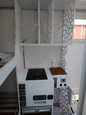

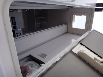

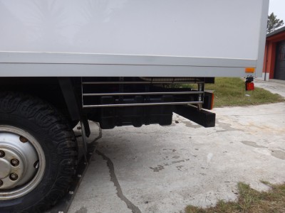

Mais quelques images:
L'appui du système sur le remplacement e lou système pneumatique de la pompe pression Truma Combi Diesel
Le deposite supplémentaire 33Lts exclusivement liée à Truma Combi Diesel, e a la plaque de cuisson Webasto X100.
Vous pouvez voir la sortie avec la contribuition de Ikea! : D
:D Abraço

Enfin, je vien envoyé des photos de "Veky" fini! Après des heures et des heures de travail, et de nombreux revers, c'est ici!
