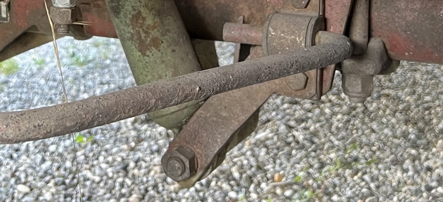

je colle ici une image reçue d'un membre ou je note une démarche intéressante de renfort de la fixation basse des amortisseurs arrières, certes ça n'en facilité pas le démontage mais ça limite l'effet du montage en porte à faux... pourquoi pas.
maintenant je ne sais pas si on a eu des retours de casses a ce niveau là en usage intensif (autre que la casse du bout de gougeon au démontage comme moi plus haut)

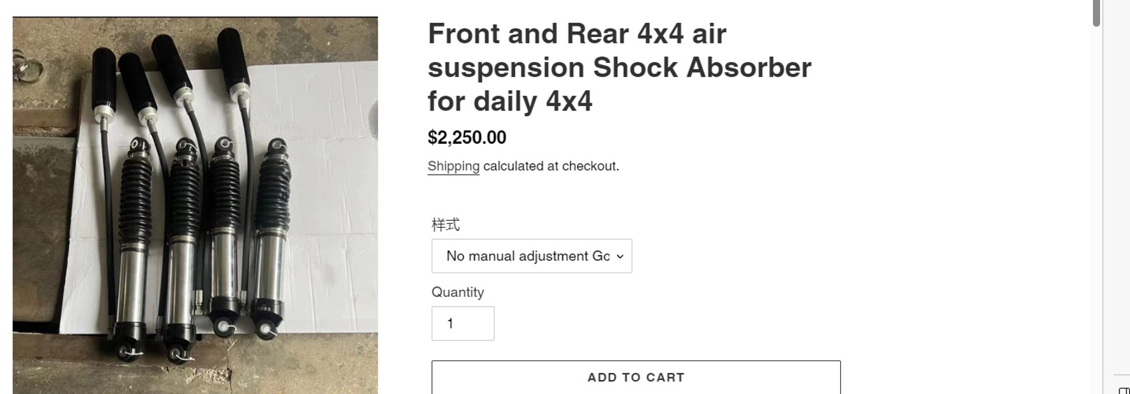

Re: architecture des supensions de l'iveco..
au passage, je ne savais pas que suonama avait aussi sorti ses amortisseurs custom a azote https://www.suonama.com.cn/collections/ ... -daily-4x4
que le premier qui tente l'aventure vienne nous dire ce qu'il en pense
"Front and Rear 4x4 air suspension Shock Absorber Strut Compatible Manual Compression and Rebound Adjustable Off Road Nitrogen Lift Kit
About this item
【Performance】Horizontal bar design, ultra-high-strength cylinder body, adopts the separation structure of main and auxiliary cylinders, the auxiliary cylinder is 99.99% high-purity nitrogen, the oil and gas are separated, the movement stroke is increased, the damping force is stable, and the time is greatly extended. service life
【Function】The height can be adjusted by adjusting the compression amount of the spring by adjusting the teeth, and the force value can be adjusted by adjusting the knob to meet the different lifting and force value requirements of customers, making the vehicle contrôle more lightweight, and can easily adapt to various complex terrains.
【Assembling】 The double combination of thread and circlip can be disassembled for repair and reassembly. It can be maintained and maintained by disassembly, so that the product can be reused and has a long service life. The 360-degree swivel joint is easy to fix, and the installation is more convenient.
【Safety】 Large size, higher strength and high handling stability. 3.0 pipe diameter design, large flow and low viscosity make the body more stable and more maneuverable. The 8-stage rebound adjustment can effectively suppress the rebound speed, contrôle the separation speed of the body and the tire, and better contrôle the stability of the body, which is suitable for high-strength off-road."
About this item
