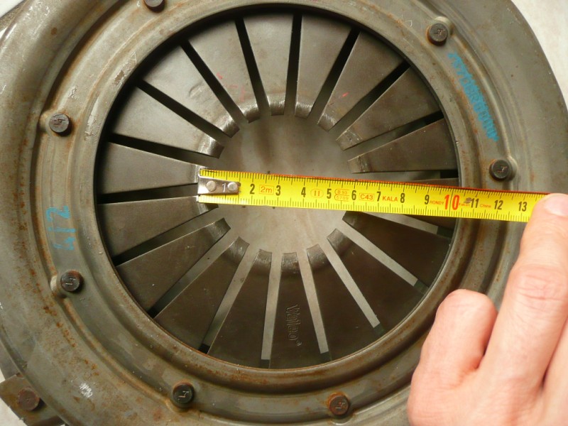

clutch (embrayage) iveco 4x4
Hi in india need to change clutch have one with me but think it is wrong! any pics or advice would be most welcome

Hi mark,
what makes you think that yours is wrong ?
I have a spare one in the basement that I took with me when we changed the one from leduc last summer but we were not 100 per cent sure it would fit so I oredered another one and depending on the place where I would go they would find at least 3 différents references... however the one I ordered did fit but the one I had in my basement did fit as well and yet it was not for the same year because mine is a rectangular front light like yours and the one from leduc is a rond front light (the old model)
viewtopic.php?f=6&t=2264
In what aspect can we help you ?
you can already take a look at the subject we did at the time... changing the clutch is a bit long but nothing difficult.
just make youself a centering (locating) tool like I did with a bit of tape rolled around a shaft. otherwise it's awfull (impossible?) to fit the gearbox without doing that first.
download/file.php?id=6596&mode=view

Hi think its wrong as the manual shows a different thrust bearing and an extra pièce in the centre also shows two sizes I have the larger size but no maufactuere names
thanks mark

would you have any picture of it ?
do you only assume that you can't fit it or you did try already ?
I was gonna propose you to find the work manual in english but from what you say know I assume that you do have it already...
just let us know in what way we can be usefull...I can send a picture of the clutch that fit mine and most probably yours...the only pièce I don't have is the center bearing...

Mickael ? (leduc) as tu pris des photos de ta butée d'embrayage avant qu'on la monte ? je ne me souviens pas?
ou bien as tu encore la vielle qui était différente de celle qu'on a monté dans mes souvenirs...?
well Mark, I'm requesting pictures of the right pushing bearing that you're holding in your hand on the first picture..since I don't have it here.
within a few hours I'll go get my spare clutch to compare it to yours...if needed we can compare the dimensions that you have doubts about.
can you also remind us what year is your iveco ? I doubt there would be any difference between left and right hand driving.

you're right Mark, I just took a look at the work shop manual and the drawing does show an extra pièce in the center but I can assure you that there is none on mine and that there was none on the one that we mounted last time and works fine this way..so it doesn't mean that yours would be wrong..marky116 a écrit :Hi think its wrong as the manual shows a different thrust bearing and an extra pièce in the centre

alright..here come some pictures...don't know if they would help you much...it fits the 2,5 l engine...is yours a 2,8 ? it doesn't mean it would be different anyway...how to be sure...
this is a valeo one and your's might be a borg and beck like the one we fitted in Mickael's daily.
