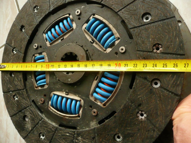

clutch (embrayage) iveco 4x4
Hi in india need to change clutch have one with me but think it is wrong! any pics or advice would be most welcome
thanks mark

marky116
- Conducteur de tricycle
- Messages : 9
- Enregistré le : 29 juin 2008 01:03
Re: clutch iveco 4x4
Hi think its wrong as the manual shows a different thrust bearing and an extra pièce in the centre also shows two sizes I have the larger size but no maufactuere names
thanks mark

- Messages : 21498
would you have any picture of it ?
do you only assume that you can't fit it or you did try already ?
I was gonna propose you to find the work manual in english but from what you say know I assume that you do have it already...
just let us know in what way we can be usefull...I can send a picture of the clutch that fit mine and most probably yours...the only pièce I don't have is the center bearing...

- Messages : 21498
Mickael ? (leduc) as tu pris des photos de ta butée d'embrayage avant qu'on la monte ? je ne me souviens pas?
ou bien as tu encore la vielle qui était différente de celle qu'on a monté dans mes souvenirs...?
well Mark, I'm requesting pictures of the right pushing bearing that you're holding in your hand on the first picture..since I don't have it here.
within a few hours I'll go get my spare clutch to compare it to yours...if needed we can compare the dimensions that you have doubts about.
can you also remind us what year is your iveco ? I doubt there would be any difference between left and right hand driving.

- Messages : 21498
alright..here come some pictures...don't know if they would help you much...it fits the 2,5 l engine...is yours a 2,8 ? it doesn't mean it would be different anyway...how to be sure...
this is a valeo one and your's might be a borg and beck like the one we fitted in Mickael's daily.
