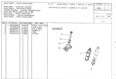

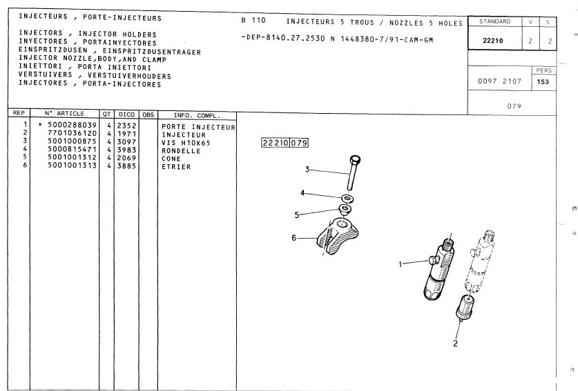

page 29 de la doc
"B 110 INJECTEURS 5 TROUS / NOZtlES 5 HOlES STANDARD v S
8140.27.2530 N 1448380-7/91-CAM-GM"
