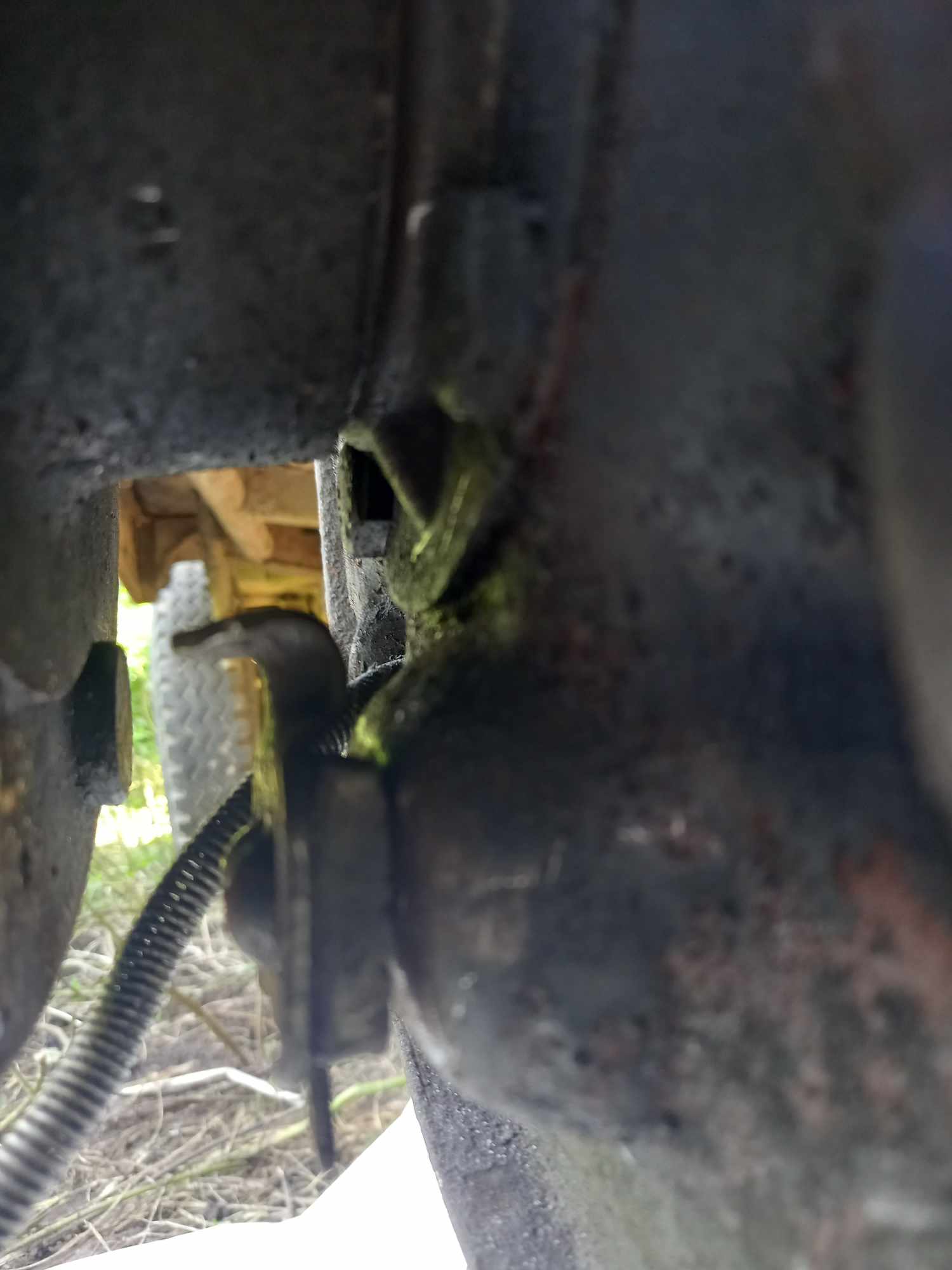

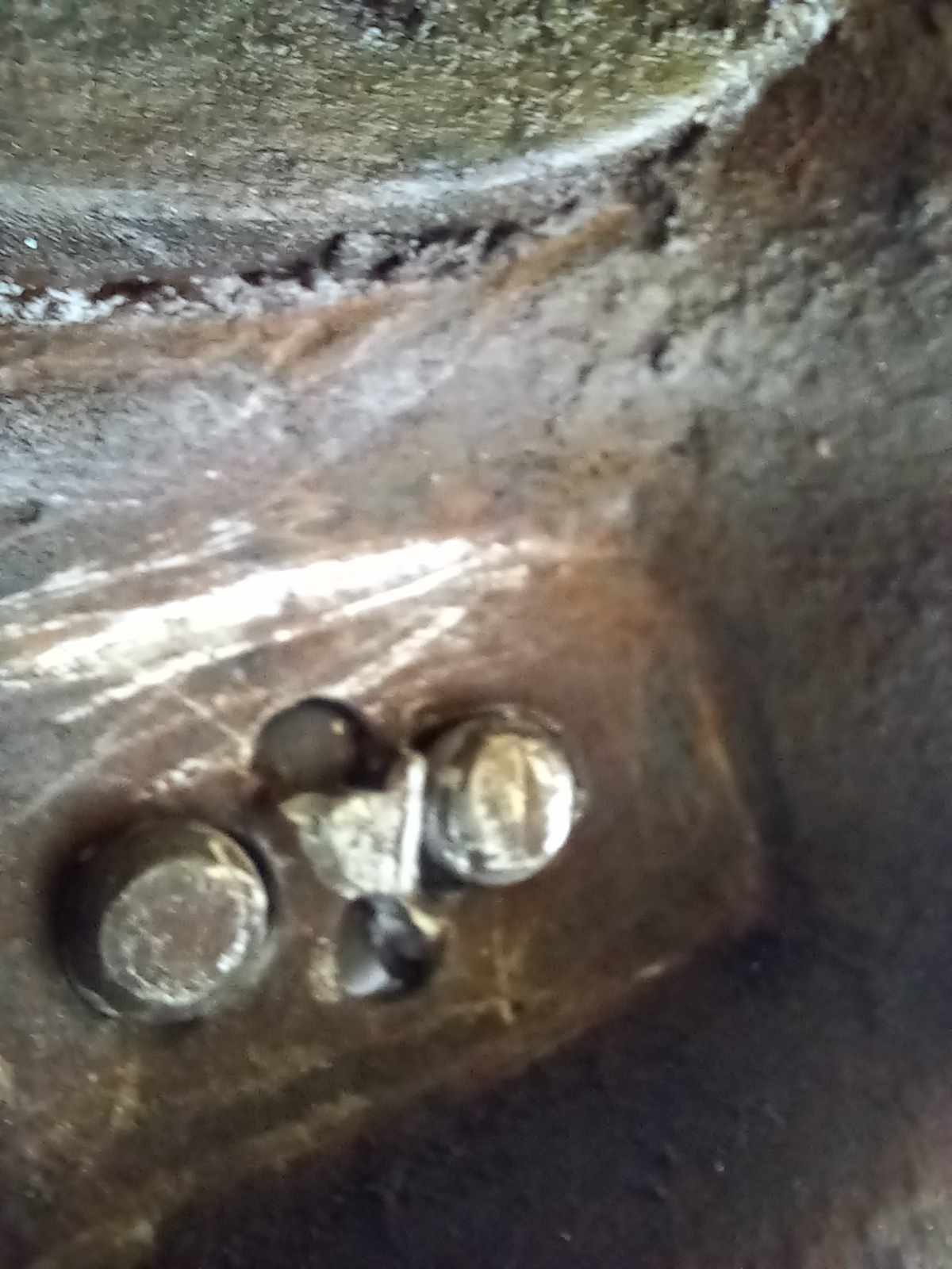

Thanks. I didnt have pictures before but i have a few now.
there is a guide block that was pulled from the rear plate. It look like the handbrake had been pulled too hard. It has ripped the rear plate.
I have pushed it back in but it is loose fitting. I may have to weld a tab on the back to hold it.

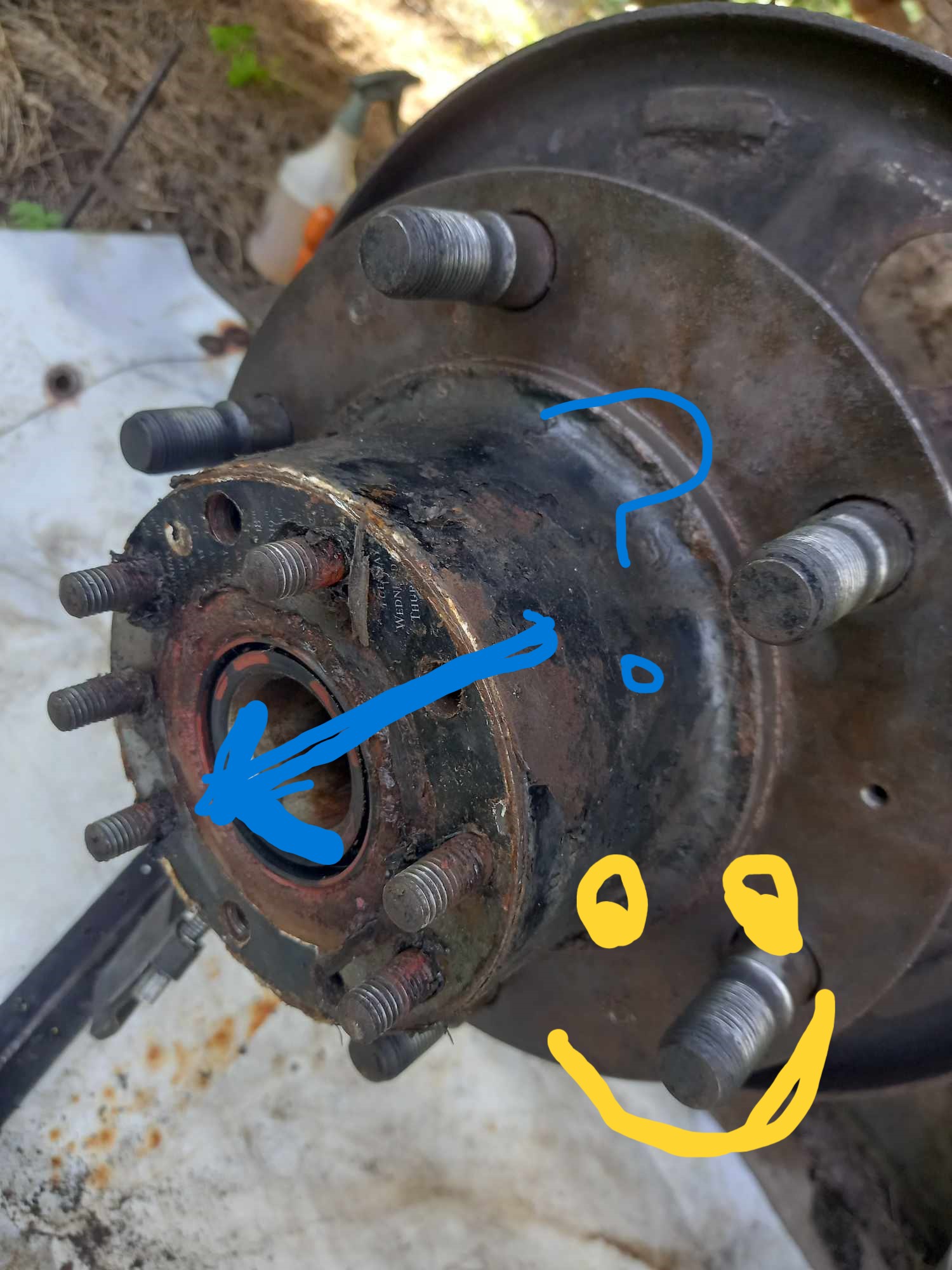

Where are the bolts that hold the hub on? Are they the same 17mm bolts that attach the back plate or are they hidden somewhere?

- Messages : 5053
Re: Hello from England. Help required with rear hubs brakes
hello
you have oil seal with metal ring, you have to take it off,behind you have the nut....
Hello everyone.
I managed to get thewheel hub off after spotting the metal plate stuck tightly to the front. Thanks for the tip.
I took the rear plate off, bashed it all straight again, refitted the shoe thing, then spent ages and ages trying to get the springs back in.
Done eventually. I was very stubborn, as I know it would have been easy if I took the hub out of the way again, but did not want to admit defeat. I still have to pull it apart to put new gaskets in and maybe the end rubber caps on the cylinder, which I of course pinched during the refitting
Thanks
