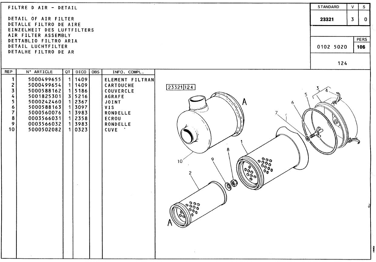

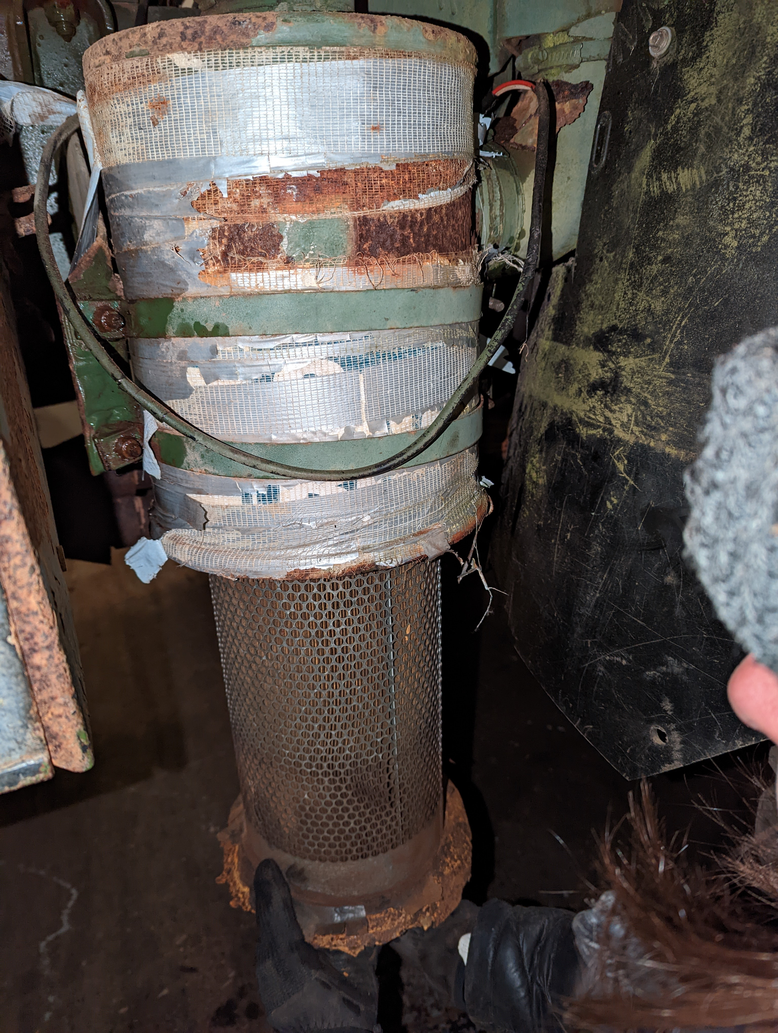

Not the filter but the housing. The filter seems to be ok, just need to find a supplier any suggestions?

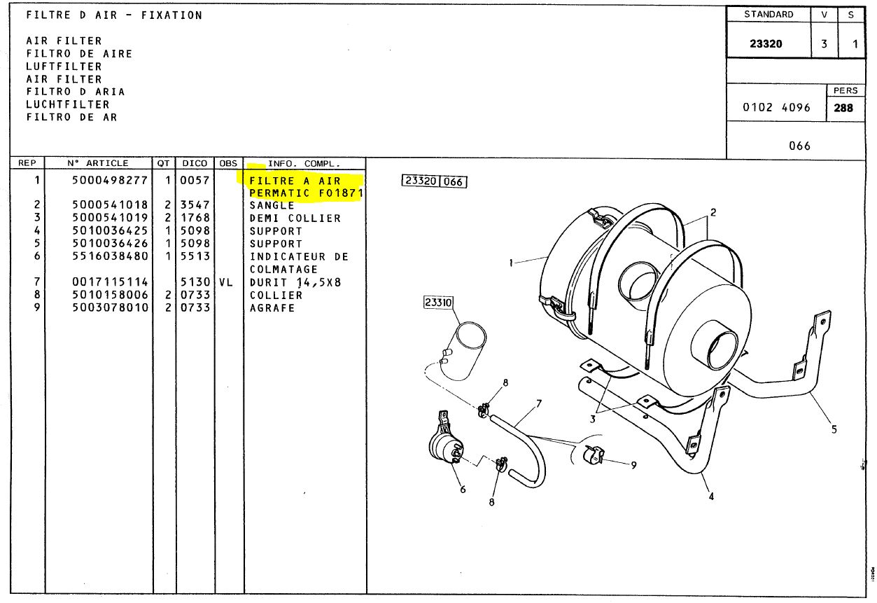

It looks like standard RVI S line model in his waterproof version.
here after one of the spare parts references with the S serie.
Hope it will help.

you can either check if you can find this reference somewhere... PERMATIC F01871

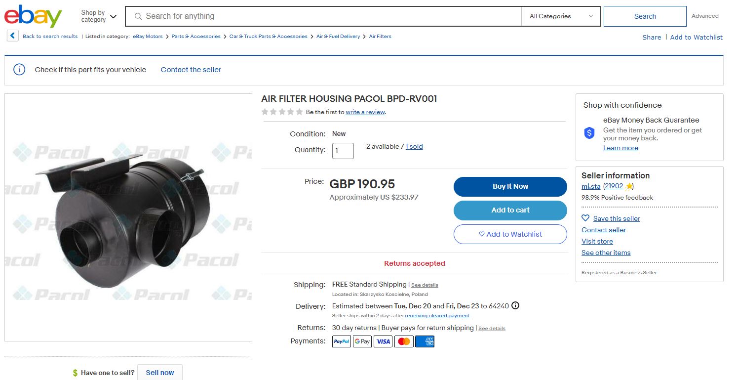

https://www.ebay.com/itm/254189532639?h ... BMhqDEs6Fh
Take care of in and out diameter...
