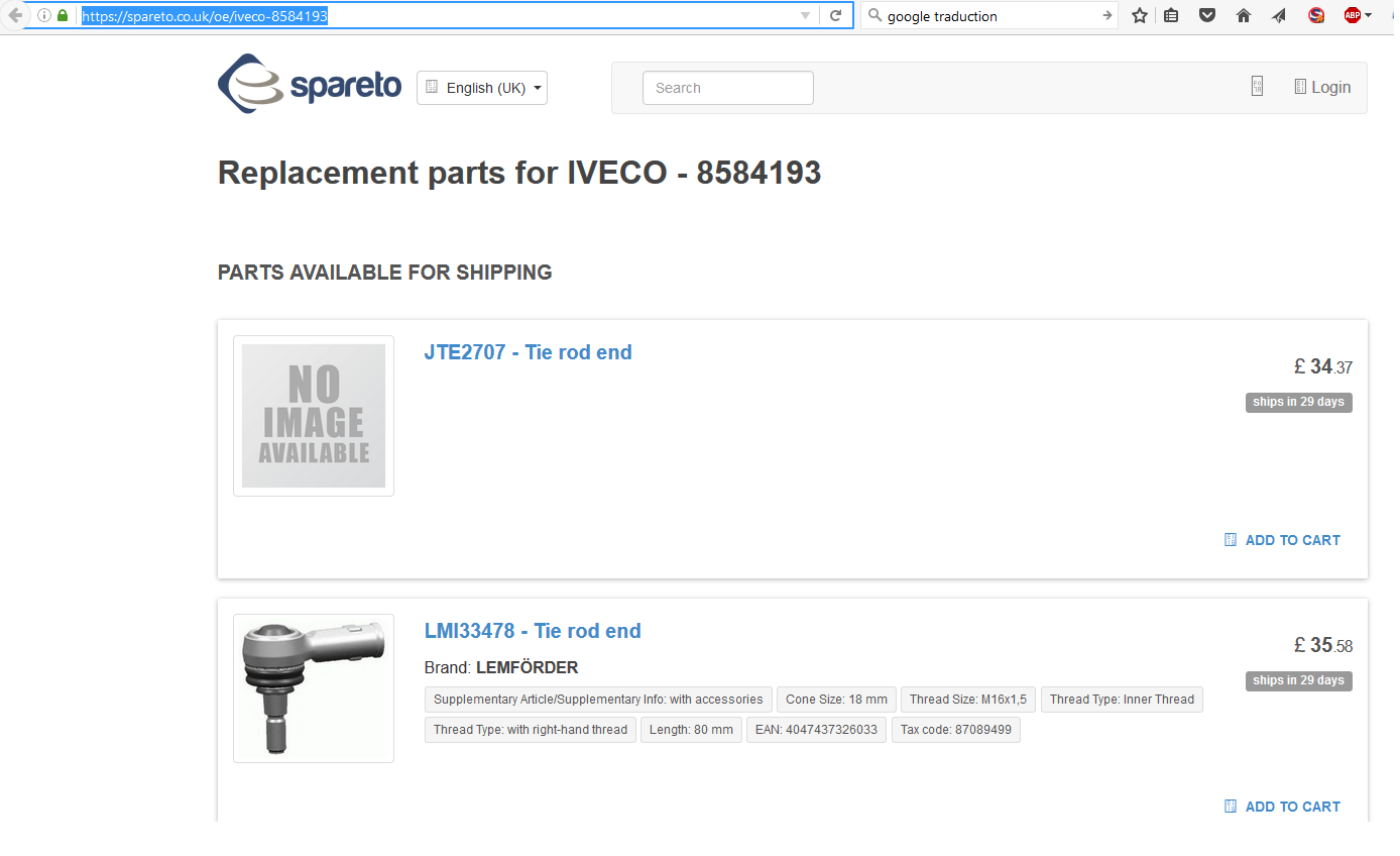

Hy,
https://spareto.co.uk/oe/iveco-8584193
if you dont find your part, i have a friend who works for Iveco France, tell me ...
Best regards
Seb
Best regards
Seb
