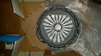

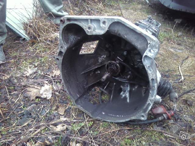

ouai c'est ça c'est le miens sur la photo...ton vieux ressemble beaucoup plus a celui de Mark ...si tu trouves un marquage de réféérence ça pourrait bien l'aider a confirmer la compatibilité...j'ai l'impression que ses doutes ne viennent que de l'illustration sur le manuel et je trouve cette illustration...disons..pas réaliste (j'arrive pas a faire une copie d'écran du pdf

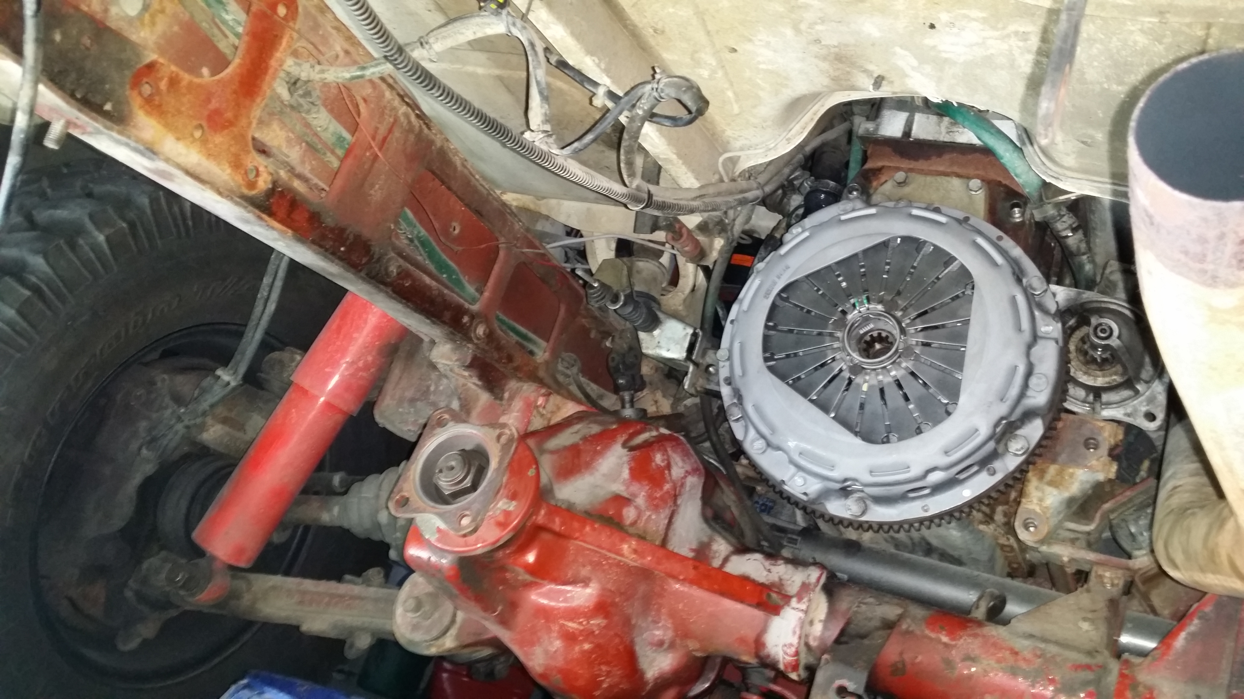

Hi folks
thanks for all the help just noted your measurments and am going to check them out in minute to see if they match. Have also contacted a supplier in Italy that is willing to send parts over if needed.
When you replaced the clutch did you seprerate the reduction unit from the gearbox or can it come off in one pièce or is it to heavy. Any advice in regards doing the job. Can it be done with one person?
My vehicle is a 1993 2.5 turbo diesel.
thank you Mark
thank you Mark
- Posts: 21225
- Joined: 27 Jun 2008 16:03
Re: clutch iveco 4x4
Hello Mark,marky116 wrote:...
thank you Mark

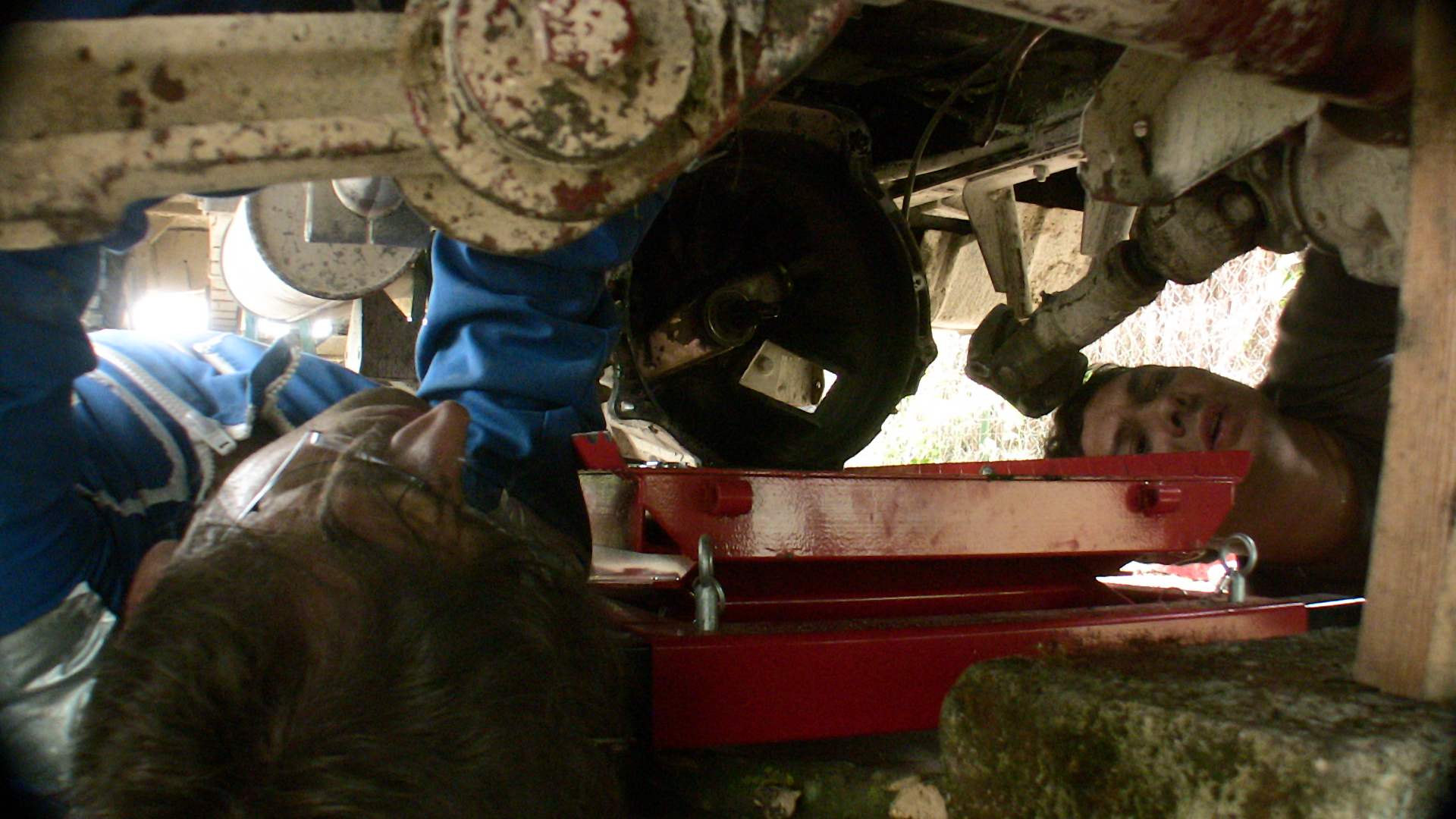

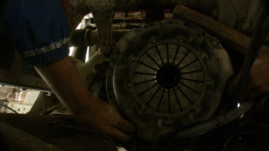

yes we did seperate the transfert boox from the gear box...I don't think there is any interrest in keeping them together..and as you said it would be heavy as hell together..especially if you're on your own...what might be difficult is to line up the gear box with the clutch to put it back in place... we were 3 to do it but only 2 at the time under the car but we used a lifting table device that did help a lot to carry the weight...you can don whithout indeed but since we had one...
well...just so you know you'll have to dismount the exhaust as well.
that'ss about it.

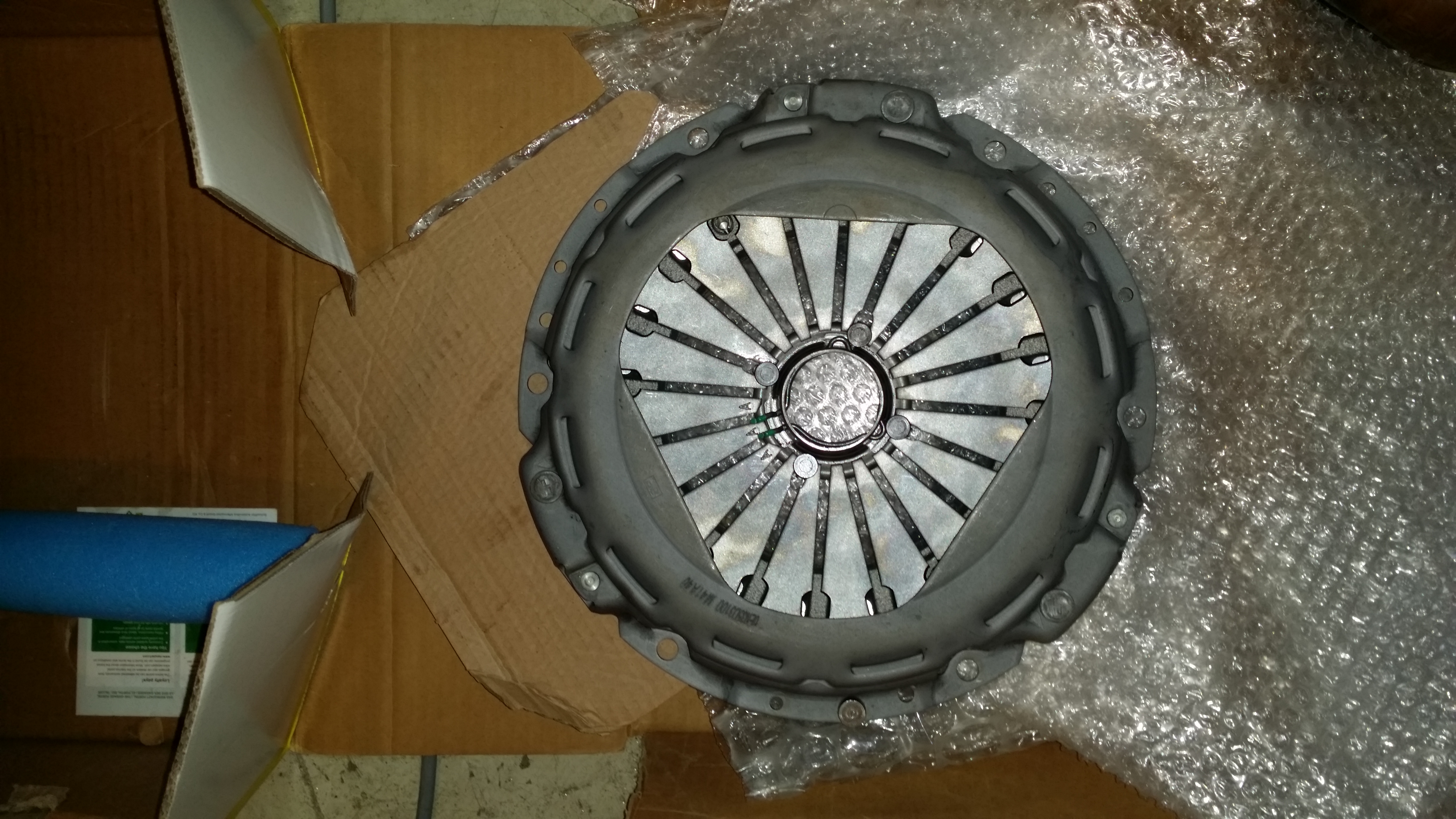

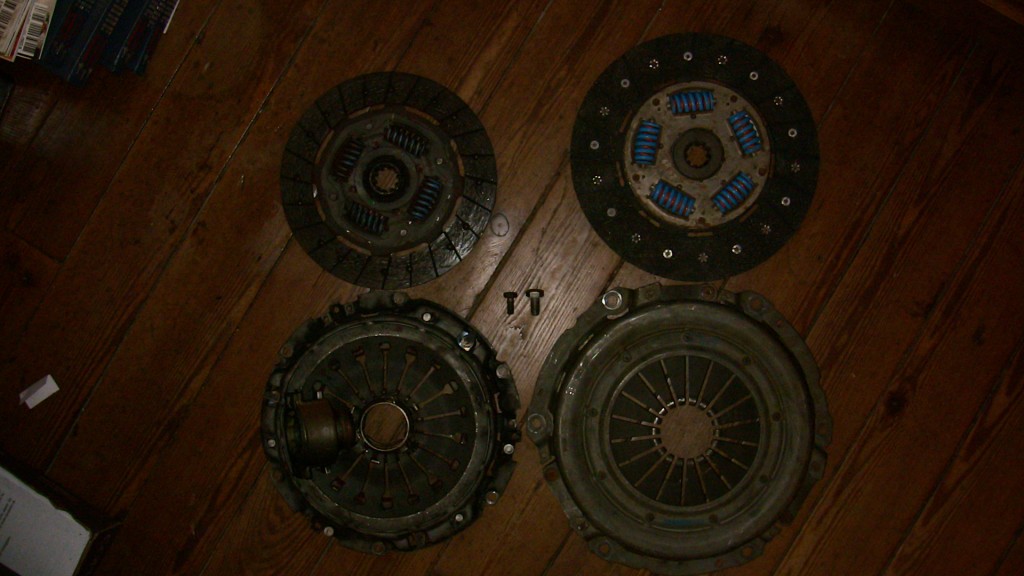

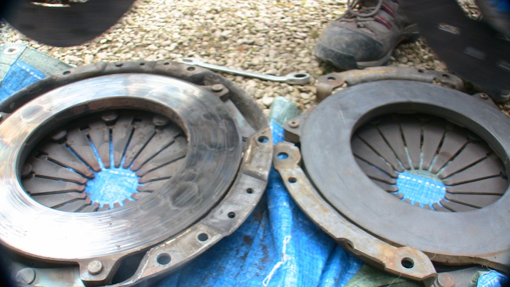

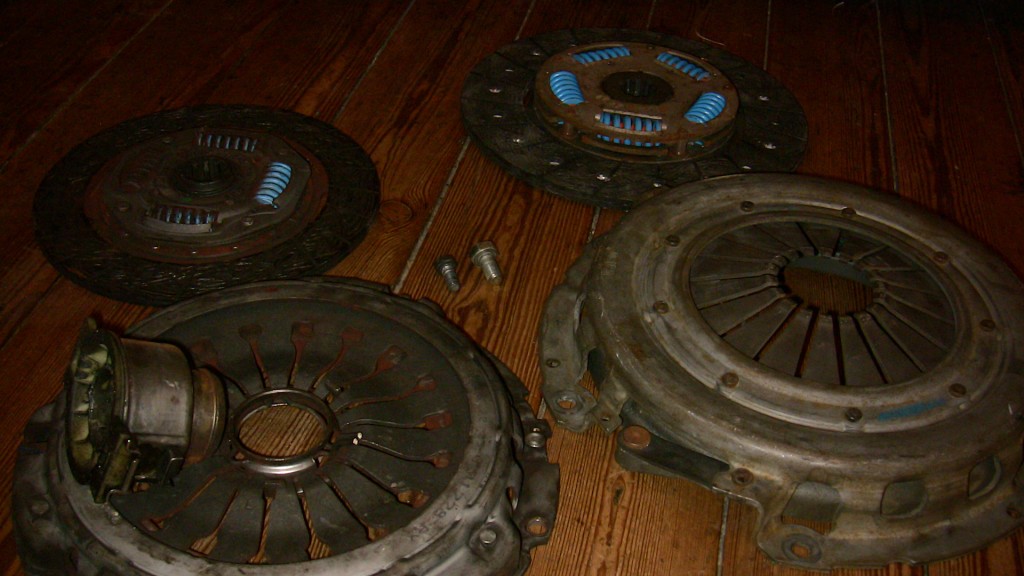

petit complément d'info sur les différents types d'embrayage montés sur iveco 4x4:
le "gros" de type "poussé" (la butée appui sur le diaphragme)...disque de 270mm de diametre
le "petit" de type "tiré" (la butée est clipée sur le diaphragme et la fourchette tire celui ci. disque de 235mm
les volants moteurs tout comme les cloches d'embrayages sont spécifiques aux deux montages:
dans le cas du "poussé" l'axe d'articulation de la fourchette est du coté opposé a l'accroche du câble.
dans le cas du "tiré" l'axe d'articulation de la fourchette est du même coté que l'accroche du câble
notez également la différence de taille des vis de fixation...
et que les volants moteurs ne sont pas interchangeables d'une version a l'autre car les vilebrequins sont égallements différents d'une version a l'autre.

Bonjour Troubadour....ouai, ça rime!
Pour ton embrayage fais attention aux butées tirées ou poussées, il peut y avoir pour une même année, les deux modèles.

Dans les 2 cas la fourchette est tirée, c'est le point de pivot qui est soit d'un coté de l'arbre de boite ou de l'autre...
attends Pascal (Hippo) il est en plein dedans en ce moment, il pourra te faire des photos et t'en dire plus long.
