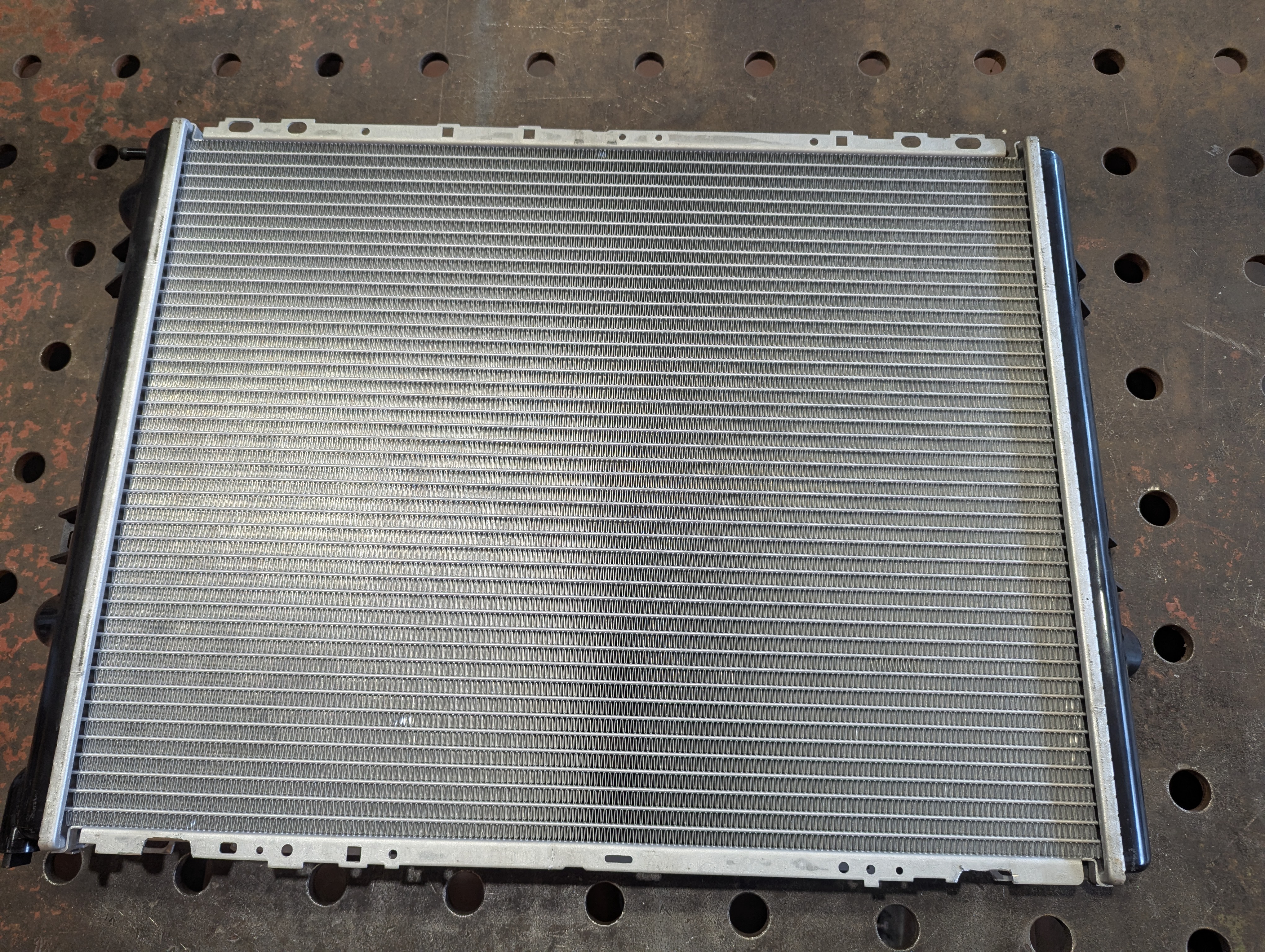

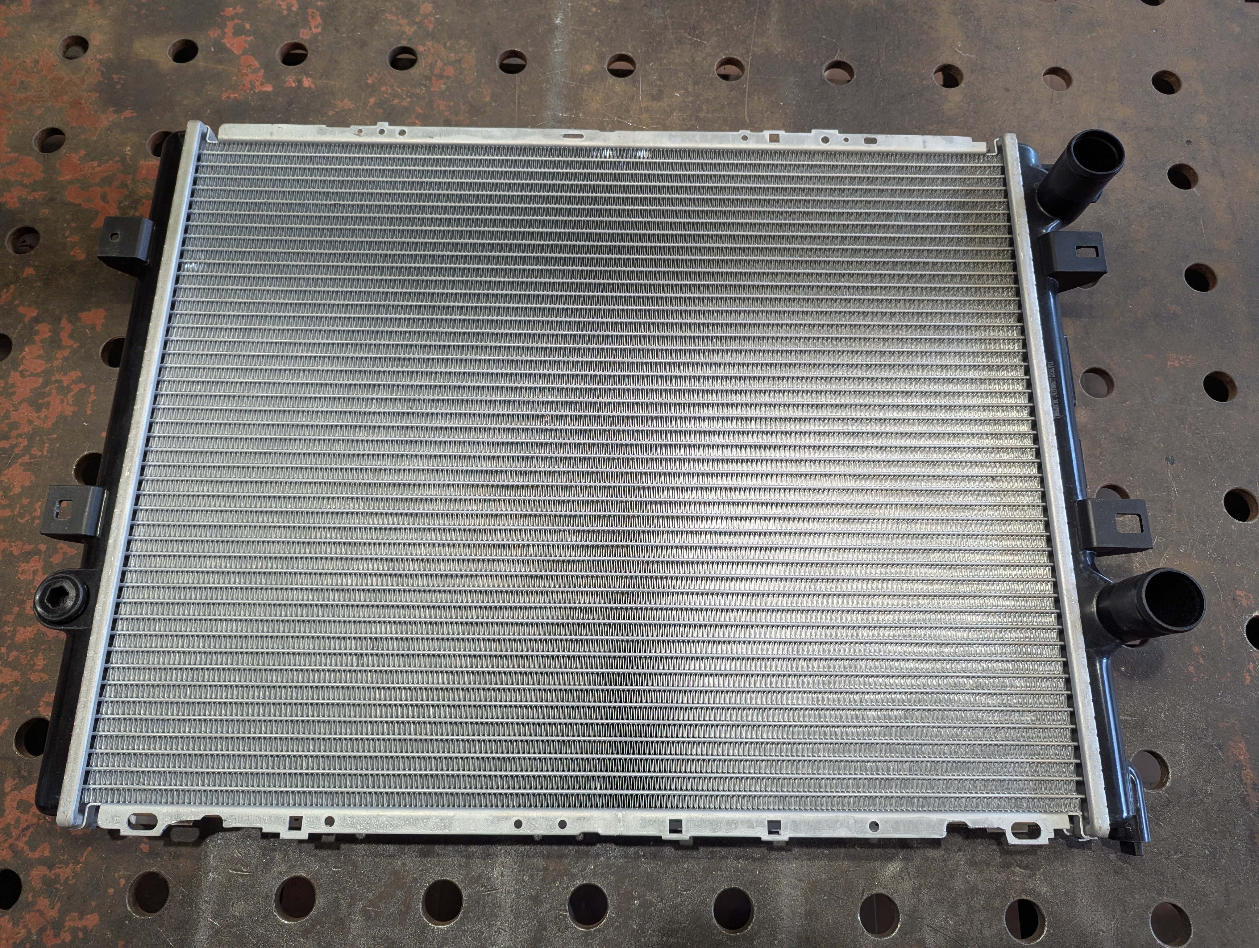

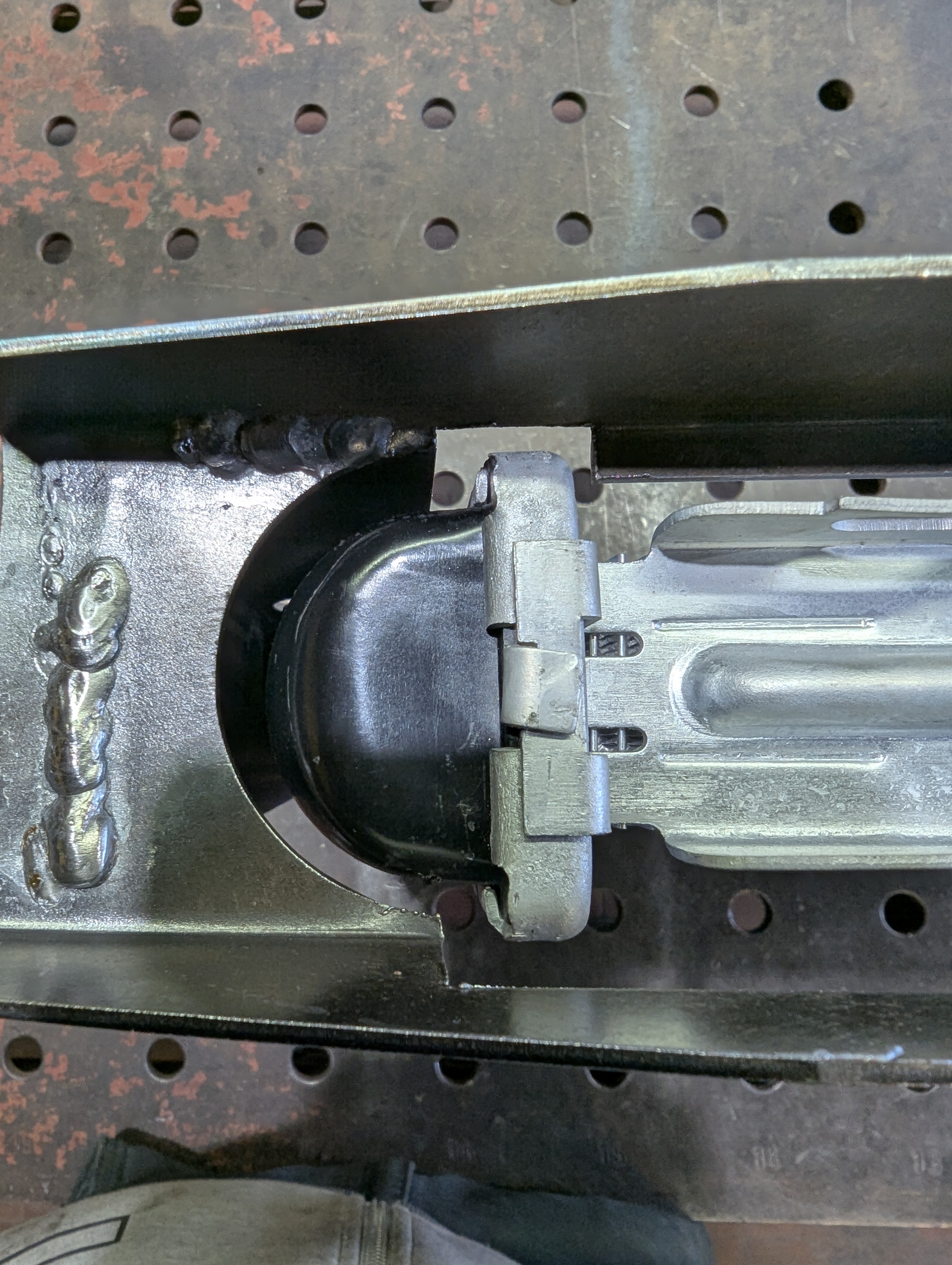

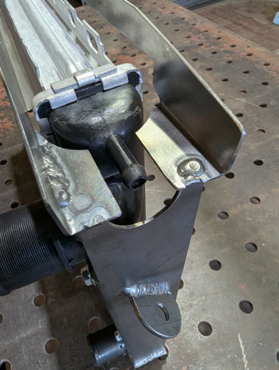

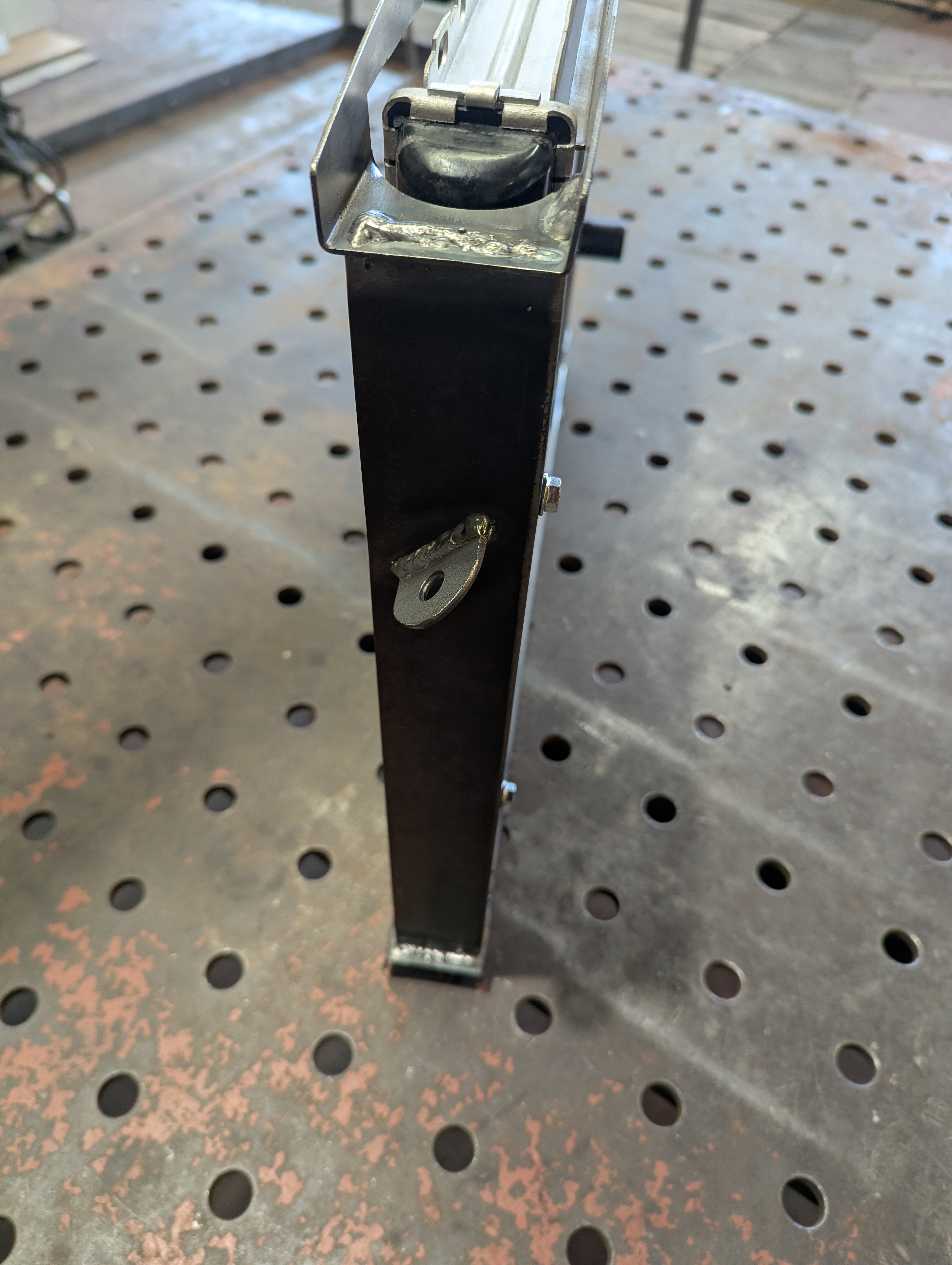

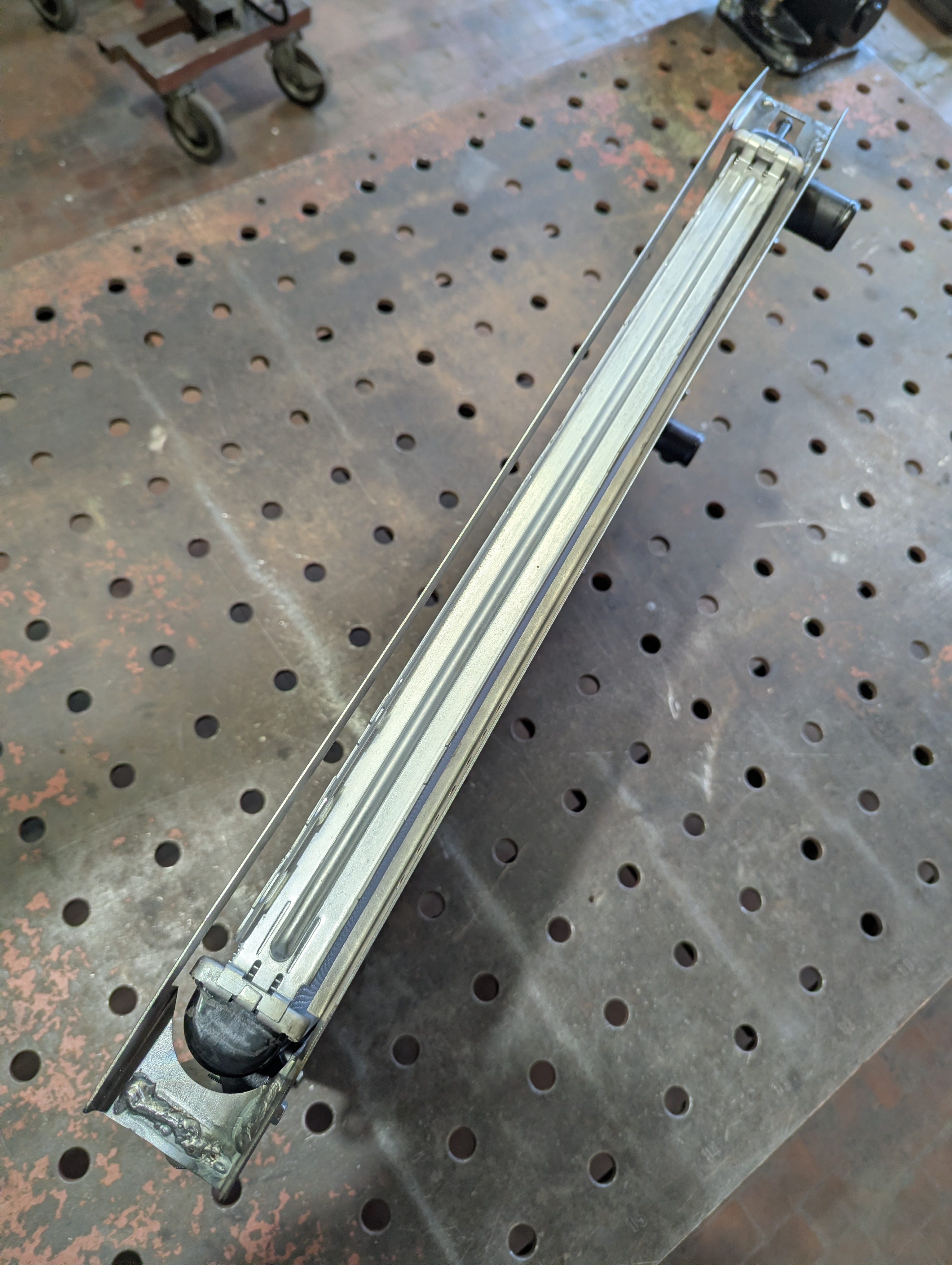

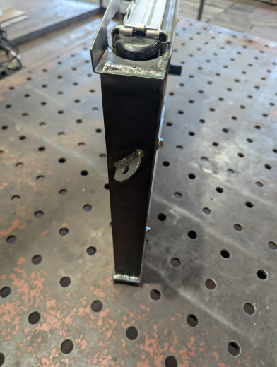

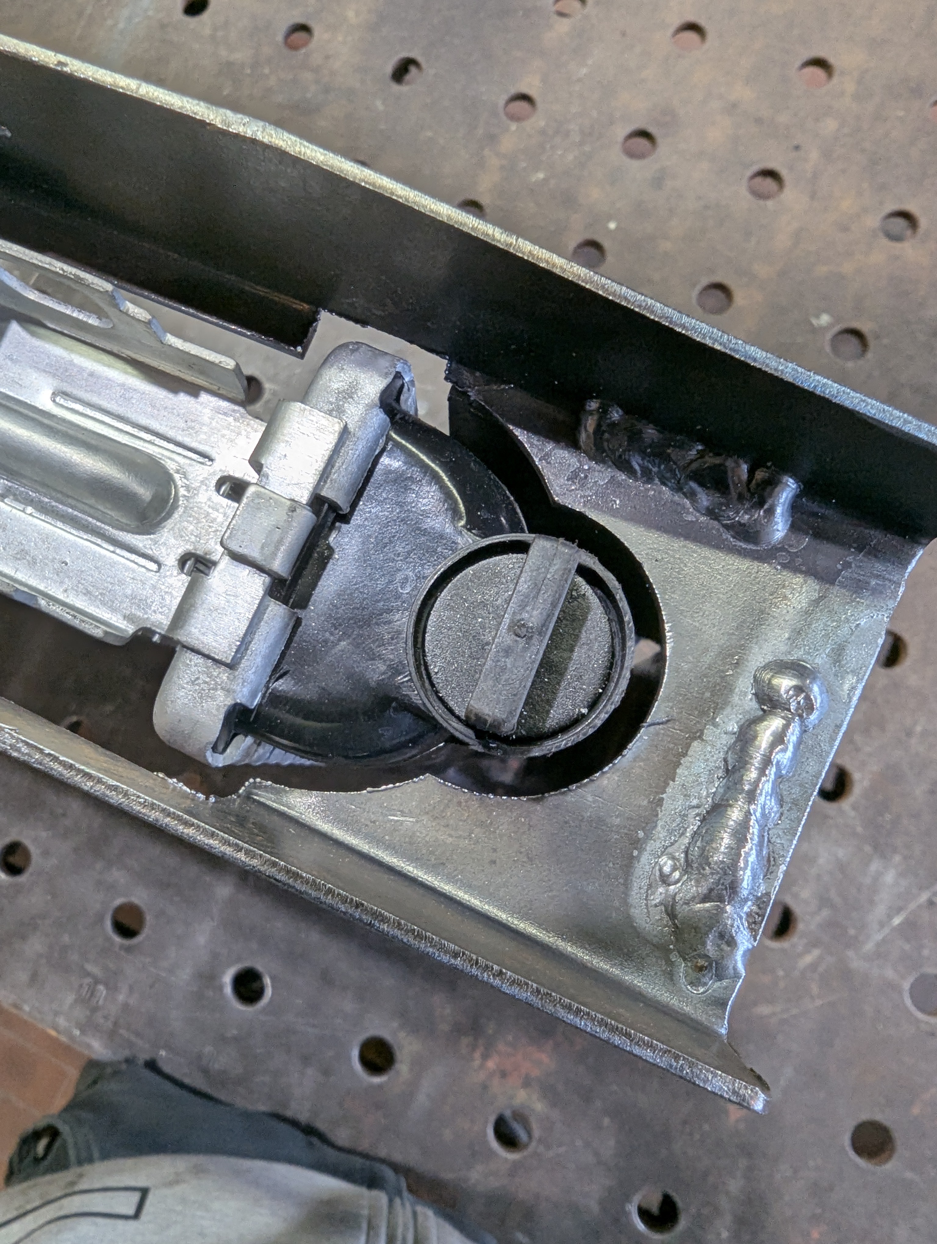

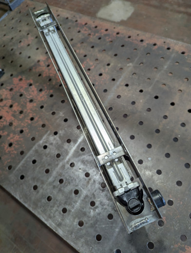

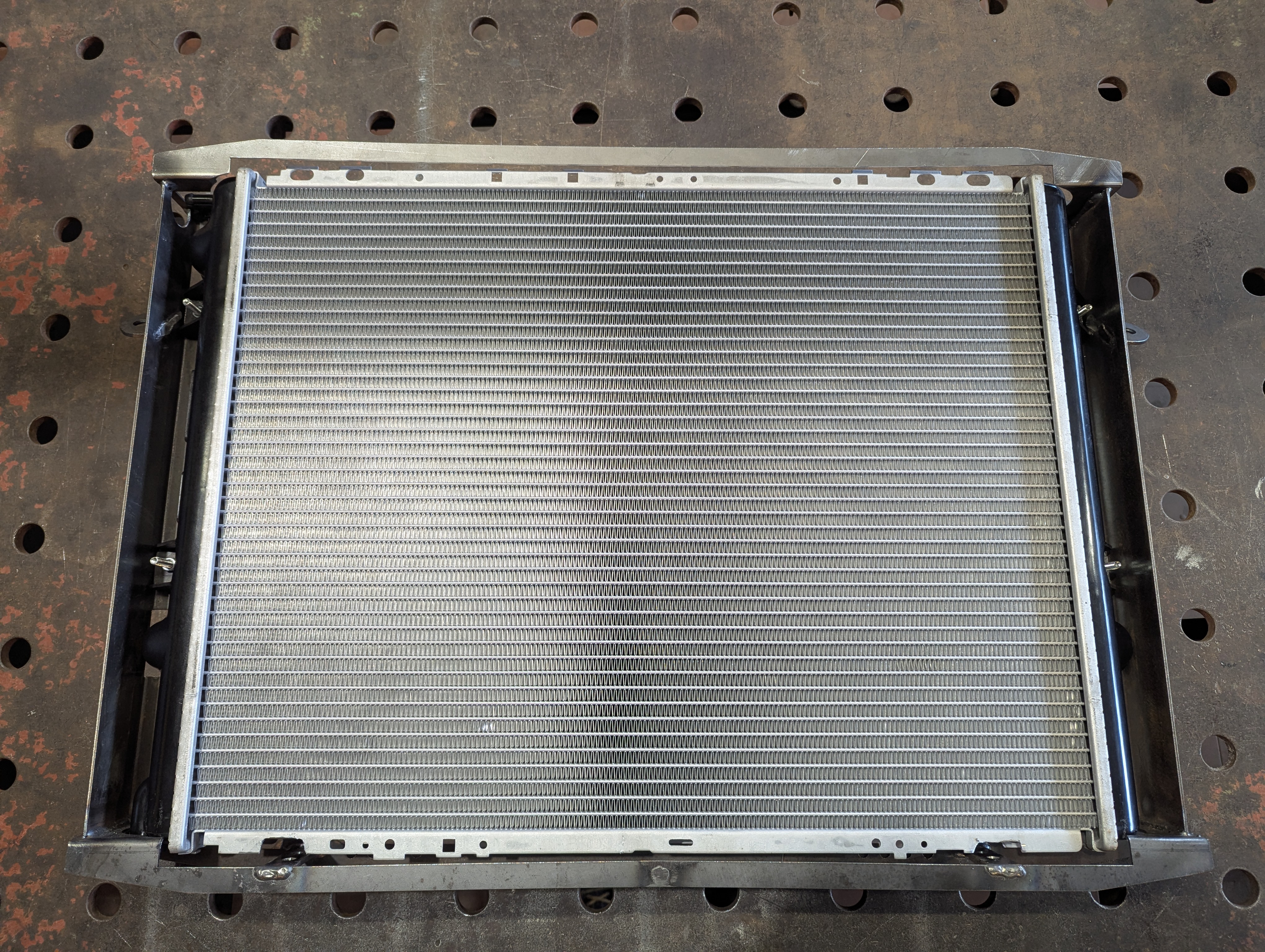

Hello!
A while ago I promised you this.

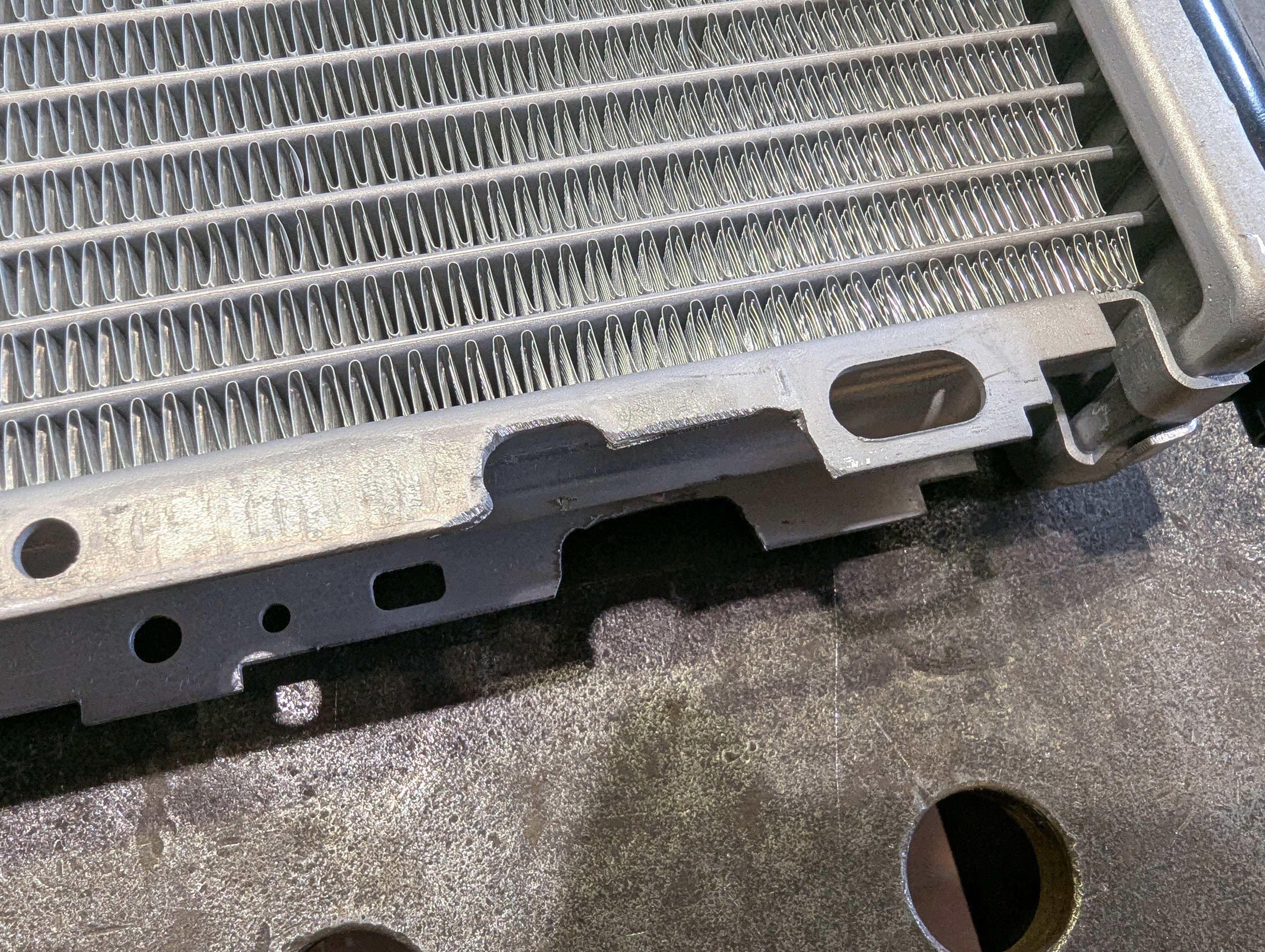

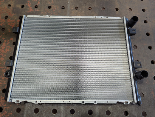

After unsuccessful search for a reasonably priced new radiator I've done a research and found out that Mascott radiator is the most similar to the original.
So I have bought a new one on ebay.de:
Thermotec LHRP993-32MT
https://www.ebay.com/itm/154029539185?m ... gname=1140

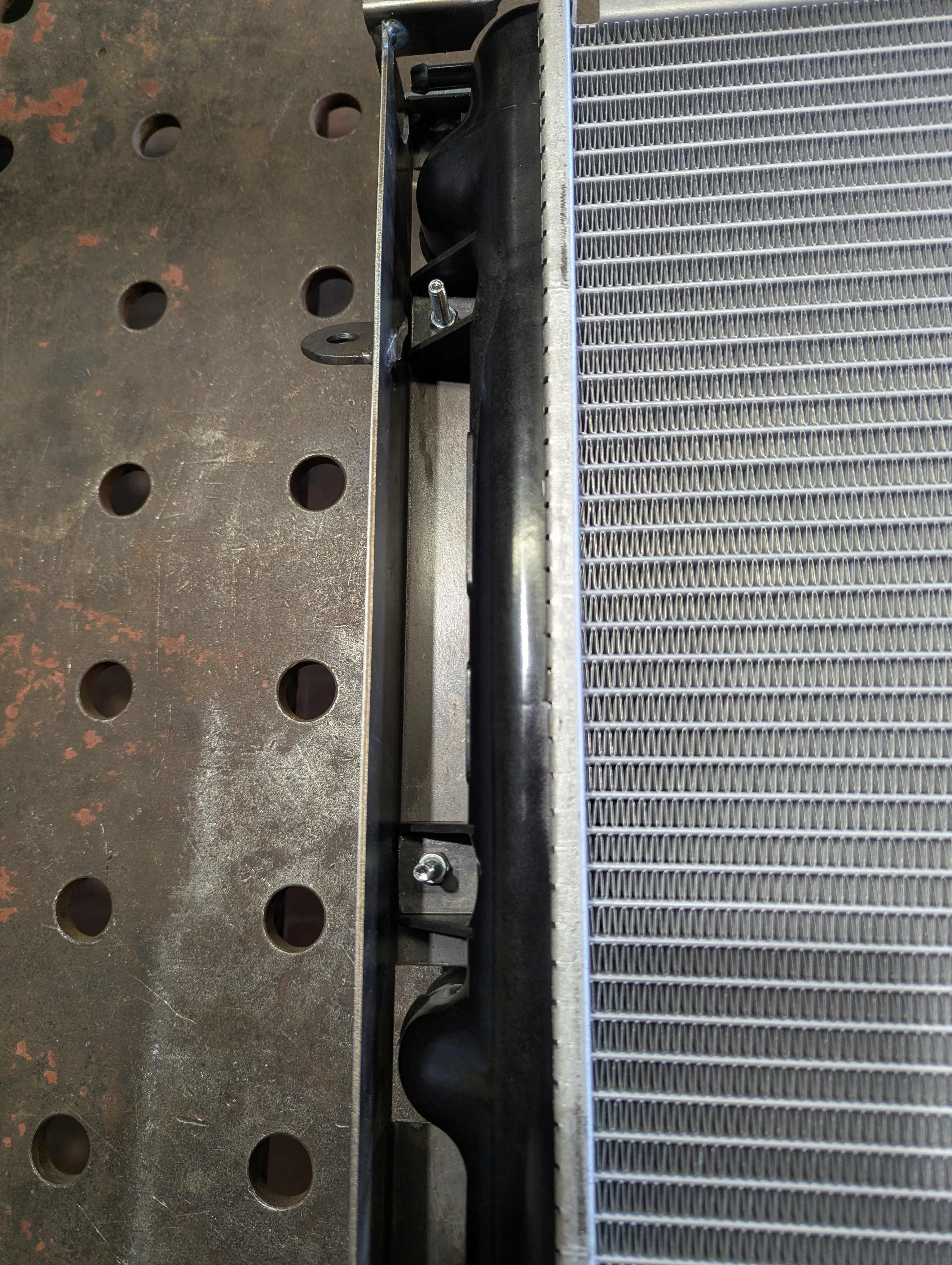

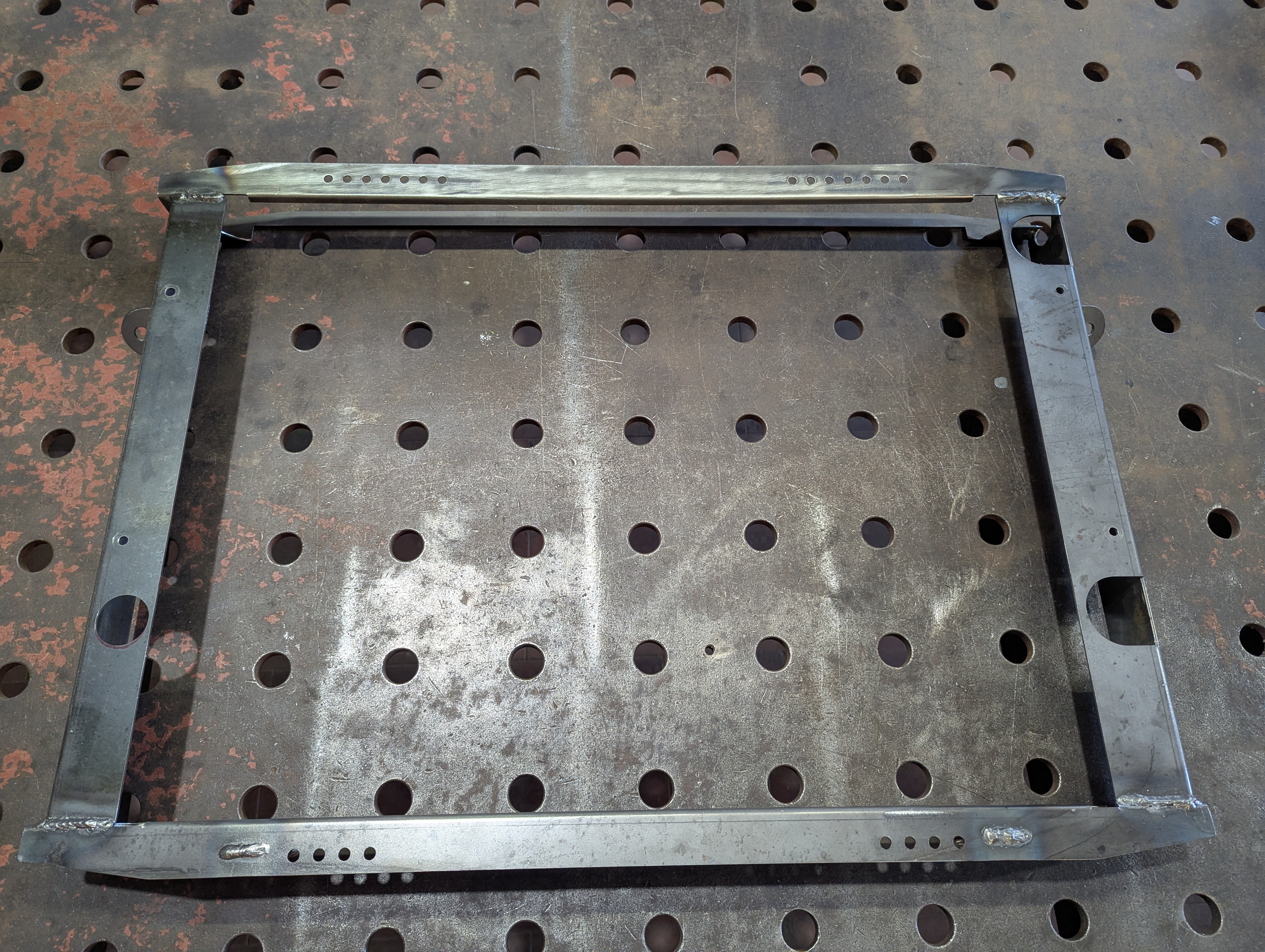

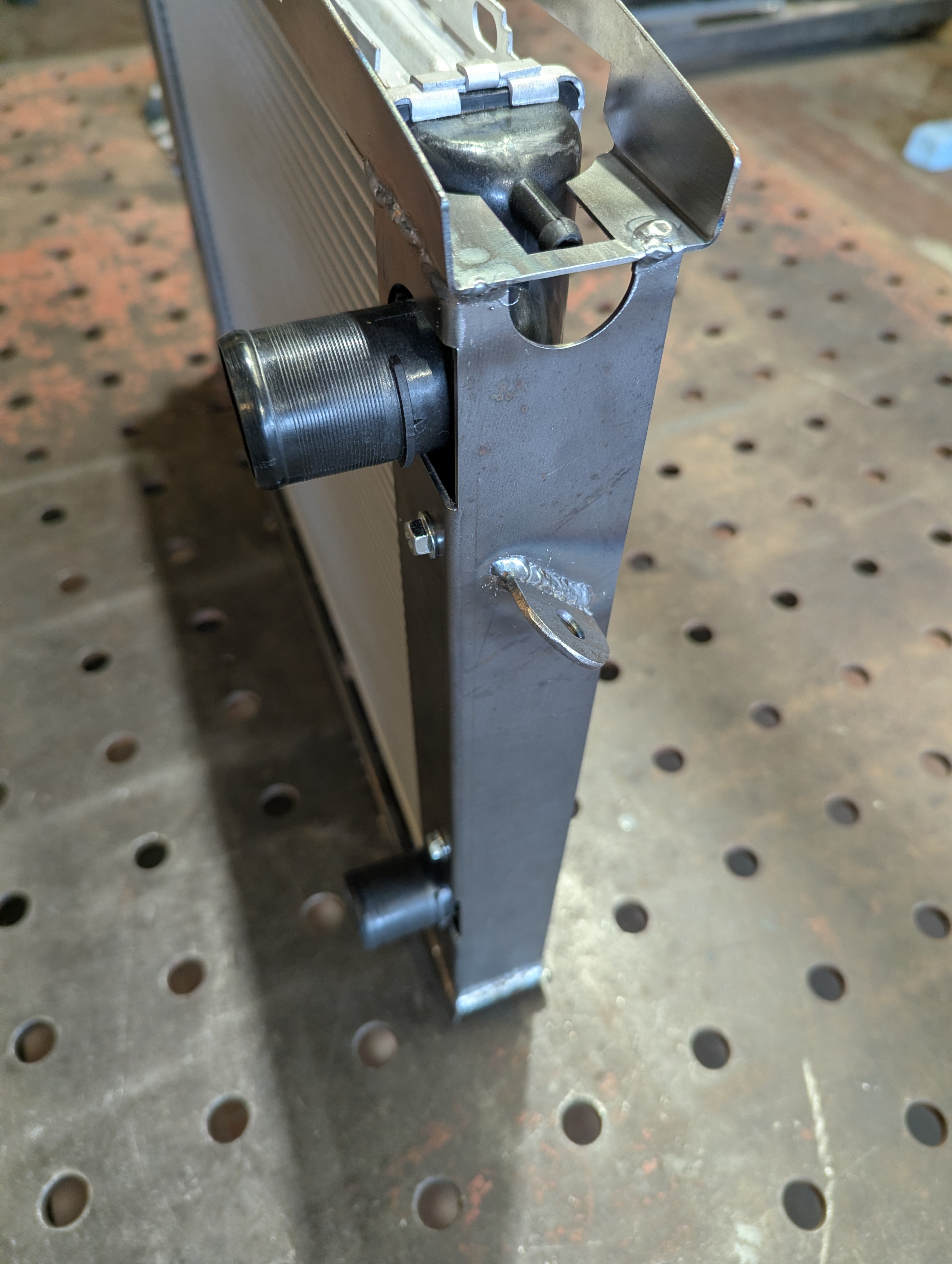

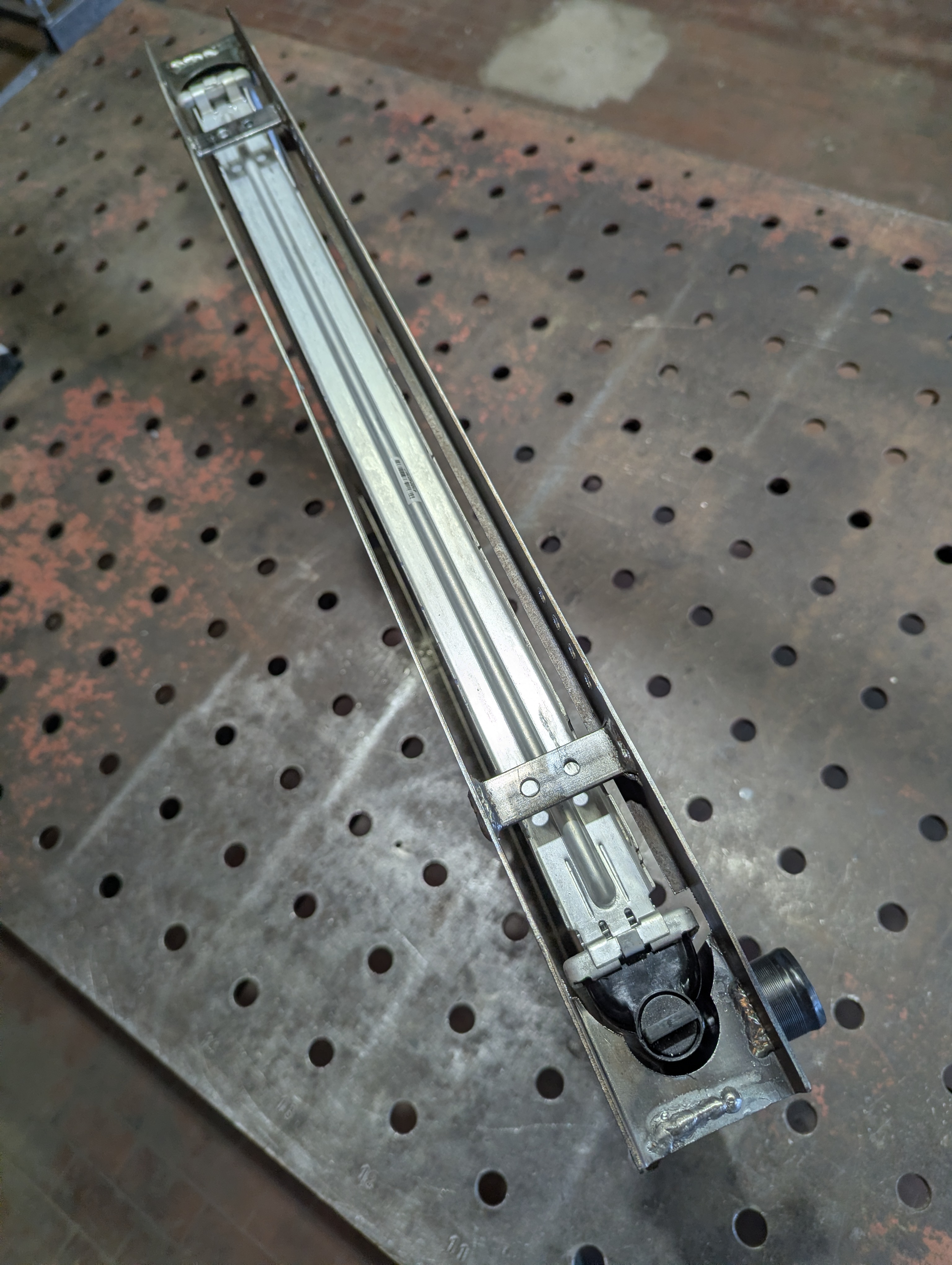

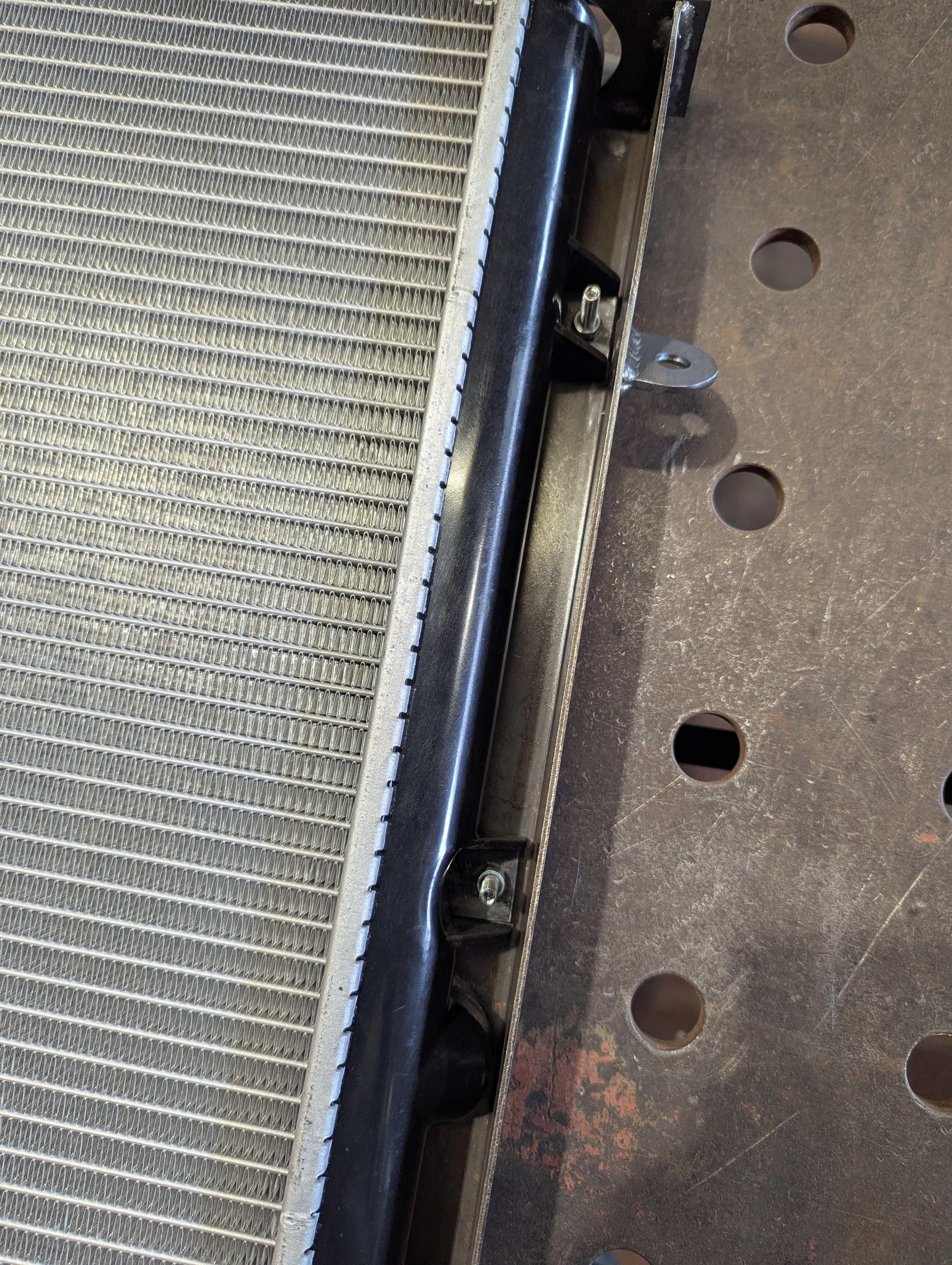

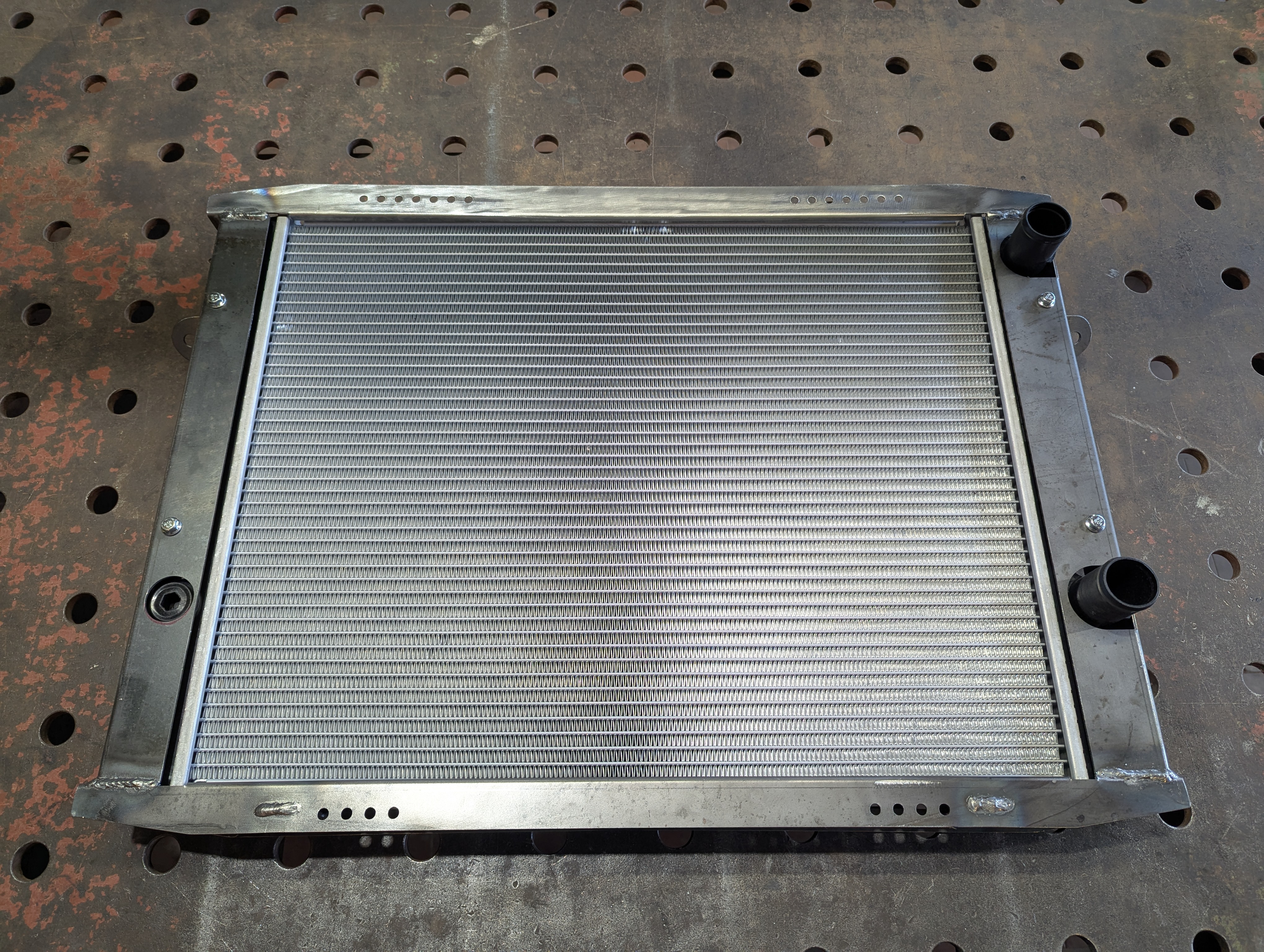

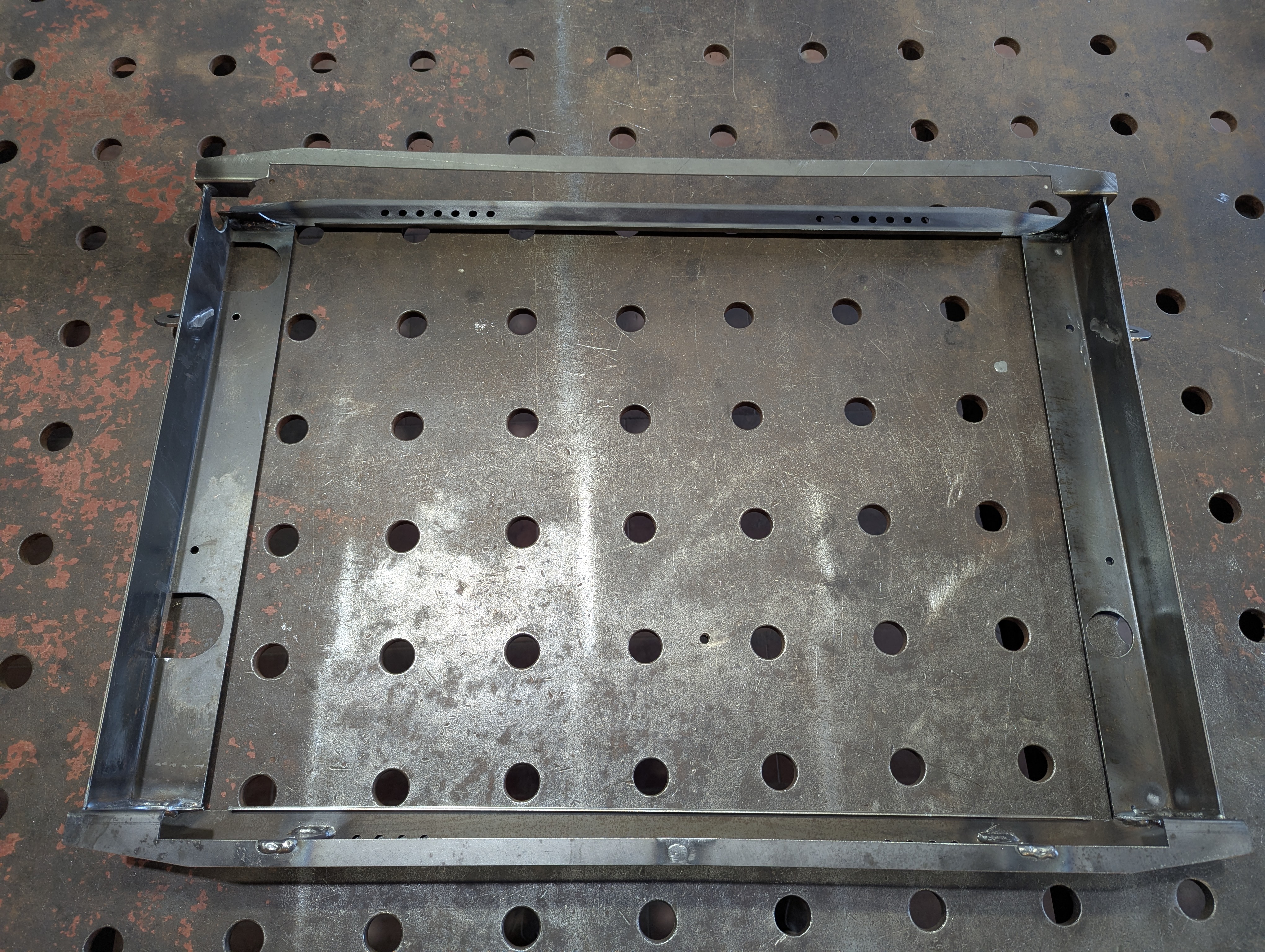

Since my van is in Bishkek and I'm in Slovenia, I used all the drawings I could find on the web and drafted the adapter frame.
The frame is made from 4 laser cut pièces plus a few brackets.
I'd like to attach the dxf file if someone finds it useful but the system doesn't accept it. So if someone needs it, I can send it.
This is the result. I'll let you know how it fits when I fly to Bishkek in May :
radiator.pdf
(29.05 Kio) Téléchargé 19 fois
radiator - laser.dxf
(914.27 Kio) Téléchargé 13 fois

Ton radiateur est-il équipé d'un raccord pour la sonde de température qui commande l'embrayage magnétique du ventilateur ?

B120 Frankfurt a écrit : 17 mars 2026 09:41 Ton radiateur est-il équipé d'un raccord pour la sonde de température qui commande l'embrayage magnétique du ventilateur ?
The location for the température sensor is on the left side. Therefore original two wires need to be extended.

Hello!
I still owe you this. The radiator fitted perfectly. We just had to take two pins off the old one and weld them onto the new adapter. One of the wires for the température sensor had to be extended, and we had to shorten one of the coolant hoses. It was an easy job.
If I had the radiator at home, I would reinforce it a little more at the bottom, but I'm very satisfied with it anyway.
Cheers,
Andraz

Bonjour, est-ce que quelqu'un a essayé d'adapter le radiateur du mascott vendu sur ebay, dans le cadre d'un vieux radiateur de B ? Parce que c'est clairement pas à la portée de tout le monde réaliser un nouveau cadre à la découpe laser 🤔. En tout cas merci pour ce sujet qui va dans le bon sens pour économiser quelques euros 👍
Est-ce qu'on peut obtenir les dimensions du radiateur du mascott pour voir si c'est réaliste de l'insérer dans le cadre d'origine du B? Merci beaucoup
