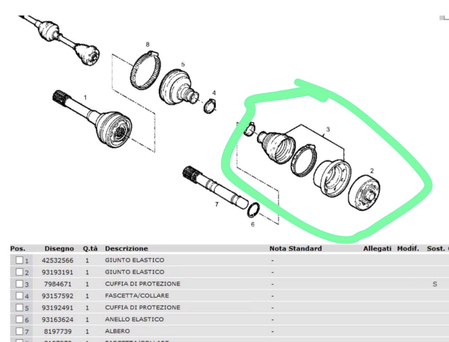

Pont avant
Capuchon latéral de différentiel
La pièce de rechange d'origine est introuvable. Je veux dire le blanc avec une bride métallique pour les boulons.
Quels écouteurs mettez-vous à sa place ?
Avez-vous des photos? Et la modalité ?

hippo a écrit : 18 févr. 2024 11:06 pour le coup c'est pas plutôt toi qui pourrait mettre une photo de ce dont tu parles ? , je dois dire que j'ai du mal a comprendre.
this number 3

ok, if you mean the rubber you can read here viewtopic.php?p=216245#p216245
i assume it is this one ; can anyone confirm ? actually I will have to get some for myself too https://mecatech-online.fr/412-megapop- ... t-4x4.html

The order link hippo just gave you is the good one.
Take care as the metal flange is not provided. So check that yours old one is in good condition.
Other important difference is the color: it will not be anymore in white! Sorry :mrgreen:

thank u all, if the metal part is not provided how can u adjust that? only with some used part from demolition?

The iveco reference 7984671 concerns the rubber, the metal flange and the clamping collar. Which means it is not sold separately.
You may have the solution to see if Iveco still has it in stock (very expensive).
If yours is not recoverable and if you don't find it from demolition (difficult because it's specific to 4x4), you can check with a metalworker if he can make one custom for you (It won't necessarily be more expensive than at Iveco).
