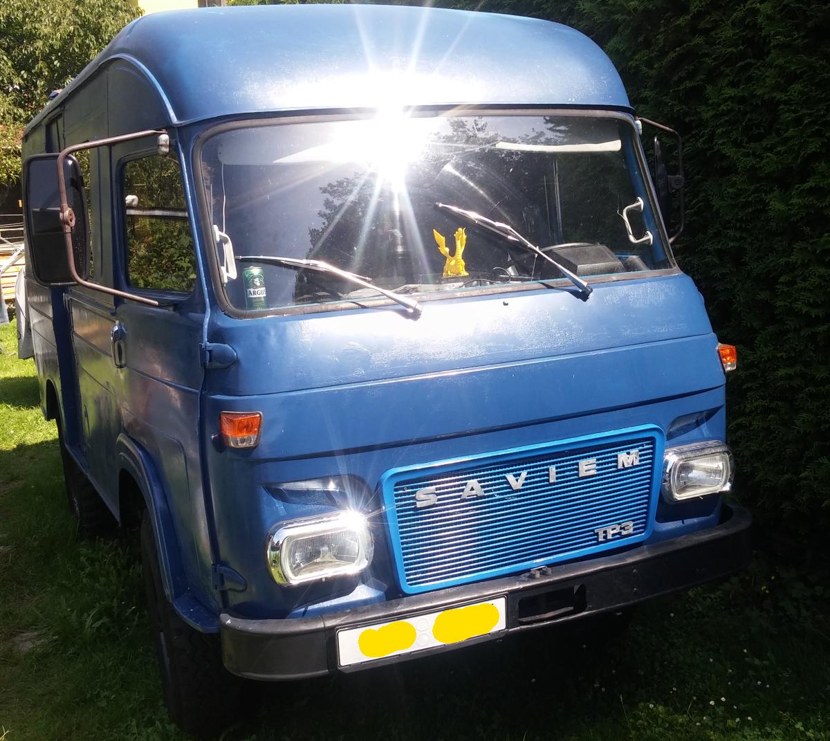

Hello, your TP3 is beautiful.

Congratulations for the work on our TP3 8)

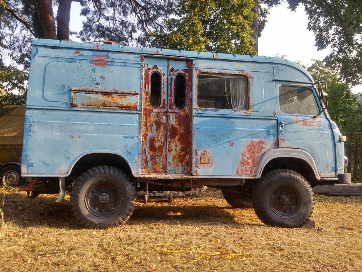

Yours has got a specification with the side door :shock: I ve never seen this before

The side door is probably the modification of a car importer to Czechoslovakia in 1971. The car was used for a mobile computer at the research institute of agricultural technology. He rode alongside the machine in the field and recorded the data.
In TP3 is many other changes from importer. In the spring I will make more photos.

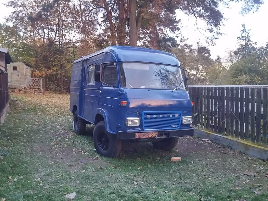

I have one more TP3 for spare parts, I'll take a picture here too.
