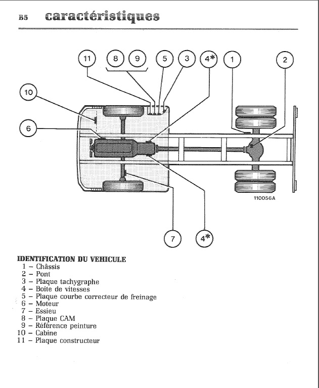

I hope you can help me, Although I have an Iveco 40-10 4x4 I am trying to find some information regarding a friends Renault B110 55 series 2wd. She is finding it hard to identify her van Via the number plate and the VIN number. The cab is from a b110 and the body is from a bus (custom). Do you know how to identify custom vehicles from the châssis/VIN number.
When we search for parts the VIN is not recognised

Hello Graeme,
Here after the Renault truck identification picture
1 - Body frame number / VIN
4 - Gearbox model and reference.
6 - engine model.
10 - cab model.
11 - builder/maker plate ==> must in place in order to identify the changes done on the truck.
Those number are the one that must help you and your local Renault dealer to find the exact spare parts.
Hope it will help you.
